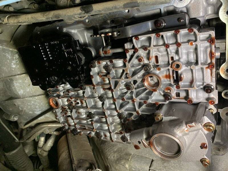

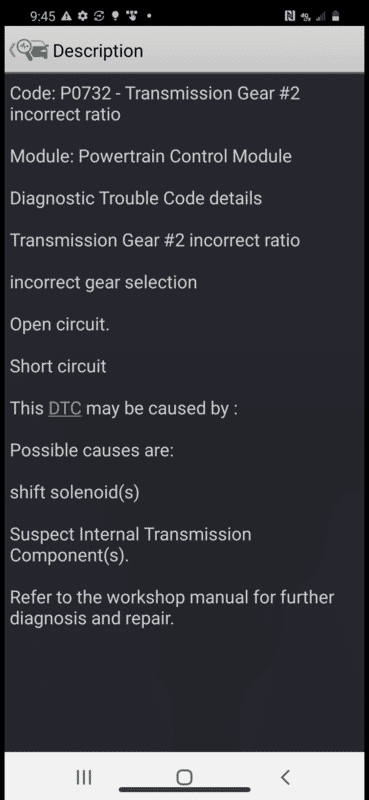

      attaching picture of code I got.
      Also attaching picture of valve body and plunger. Plunger has a little bit of sludge in it, but doesn’t seem terrible. Haven’t dropped valve body. Looks clean on underside.
      thoughts?

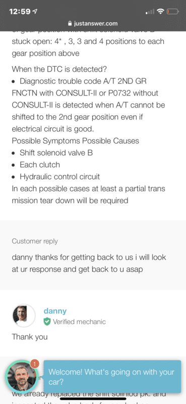

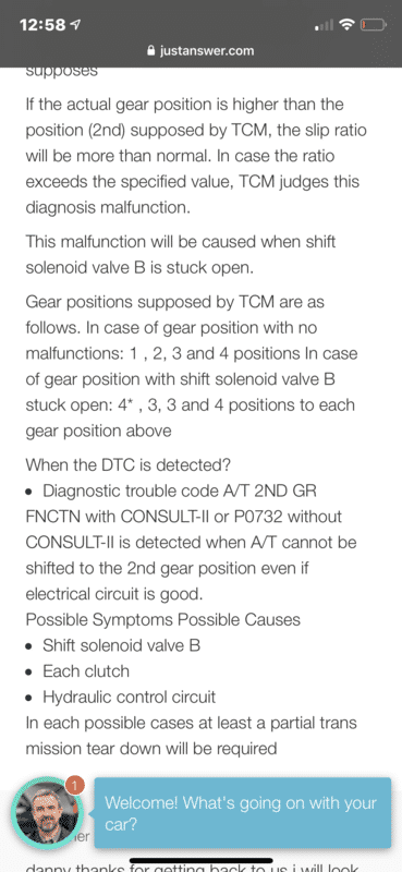

      Found this, feel free to chime in on accuracy.
      Solenoid pack maybe?

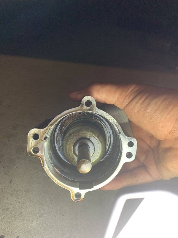

        Found this also.
        And I forgot to add I was expecting more fluid to come out. I’m going to measure what came out, but seems like it could have been low. I’m hopeful that with new solenoid, filter, and fluid she will be good.

        Removed valve body tonight. Looks extremely clean. Fluid smells good, and looks good. Normal amount of clutch dust on the pan magnet. unbolted solenoid, but still seems stuck in its joke. Is it just supposed to yank out?
        Only thing I noticed on valve body is there is one valve that moves freely (but I know nothing about them so don’t know if this is normal or not.
        so, seeing as how everything is clean, I’m still leaning towards maybe old/low fluid and possibly bad solenoid. Considering putting it back together in the morning and filling her back up with new fluid and filter and seeing how it does. If still having issues, maybe replacing solenoid after.
        any input welcome.

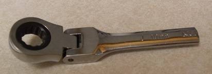

        Did you remember the bolt on top of solenoid...you'll need a 10mm swivel Ratchet cut off to about 3 or 4 inches to get it off
        Solenoid R&R - 2002 Lincoln LS V8 (5R55N)
        Remove - 1 Bolt (10mm - Gear Wrench with Flex Head) on top of Solenoid Pack, holding the electrical connection on.
        Note: I cut my "Gear Wrench with Flex Head" down to 3 5/8" total length
        ** This is a Very tight area to get at with a wrench
        Remove - Solenoid Pack - 8 Bolts - T-30 Torx Bit - (7 long bolts, 1 short bolt)

          FWIW I went to Harbor Freight and bought the set it has the 10mm Ratchet ...remember to cut it down or it will never fit

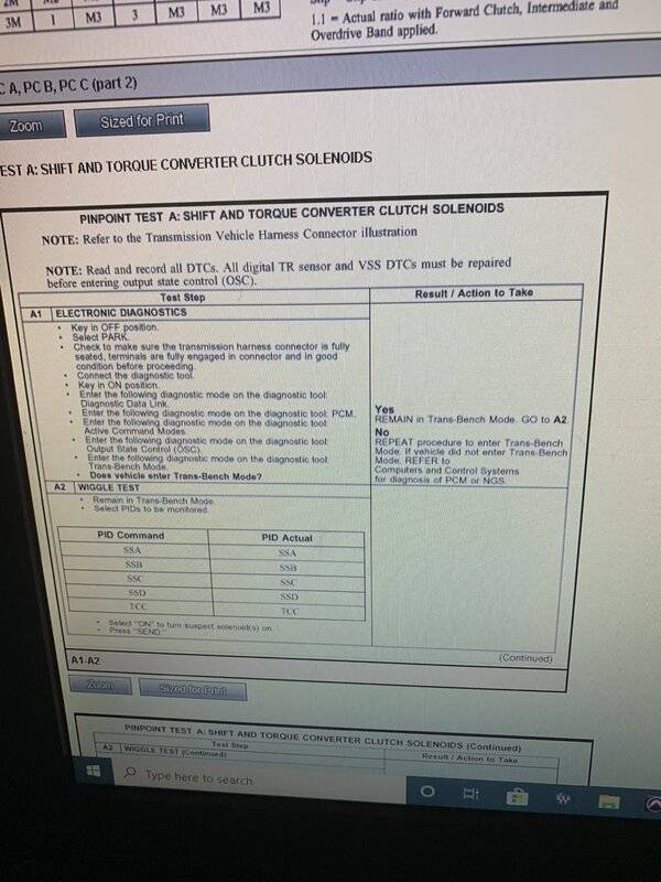

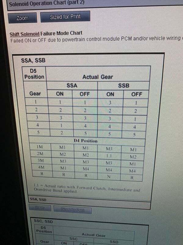

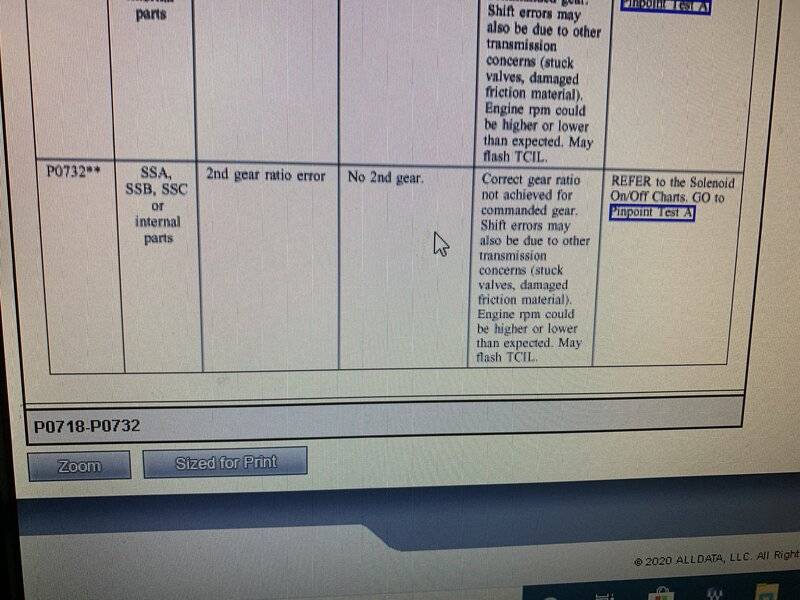

          I noticed some of the test on All Data guide through what’s called a Trans Bench test and monitors the solenoids. Can Forscan do this? Or would I need one if the big scanners a shop would have?
        • Caleb
          Caleb Active LVC Member
          Messages:
          58
          Likes Received:
          9
          Joined:
          May 12, 2020
          Location:
          Diboll TX
          Here are the pictures. Obviously I have no idea what I’m looking at for the most part lol not sure what SSB, and the rest mean. I assume referring to each solenoid and their state.
