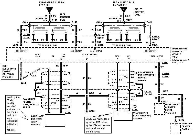

I am fairly sure the Mark VIIIs without COP don't use the cam sensor.
Incorrect.

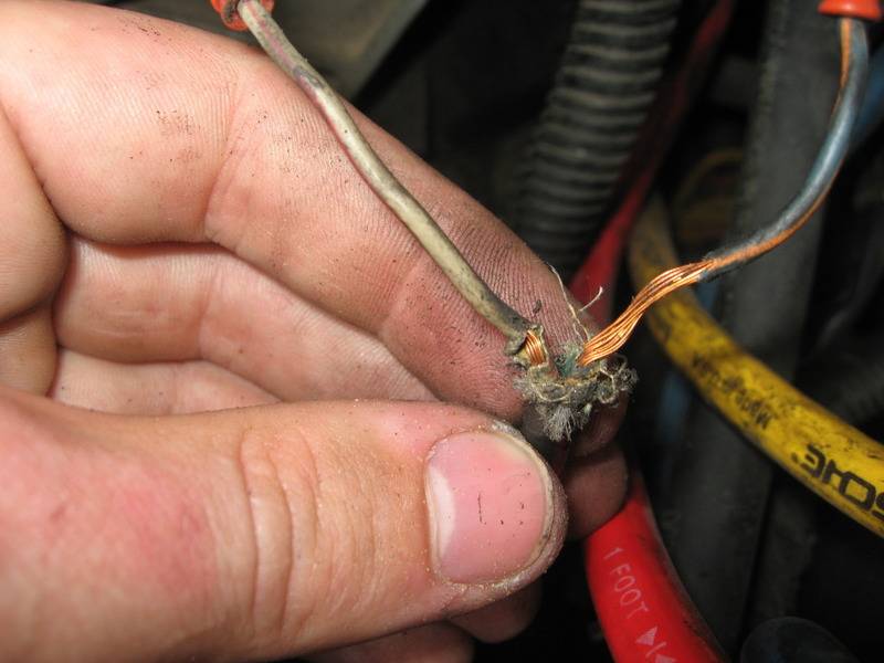

is this a problem? geez. that's at the cam sensor. i'll check the wires at the crank sensor next.
since they are shielded wires, i'm going to go ahead and assume that two wires with no shielding at all probably made something angry.

Ah I see. It does not use it for ignition though. It must just look up defaults for the injectors if there is no cam sensor signal.
must be. there is probably also a much larger margin of error for the firing of injectors. pretty sure some older eec iv systems were batch fire, so it just popped the whole left side at once. if that works, then an educated guess for a sfi system would be fine.
sounds like my issue is crankshaft position sensor related then.
With a bit more thought I'd guess the EEC just fires both injectors like it fires both plugs. It really has no other way to know which side to fire without the cam sensor. I'm not sure how that would work without misfiring though.
