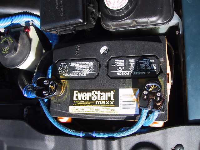

Hey driller, by the way, would you mind revealing where you got those terminals and wires? and an approximate cost?
Driller, did you get your battery at Wal-mart? If so, does it fit correctly in your car? I got the suggested battery from there a while ago, and it is very snug inside the battery tray, actually larger I think. I'm wondering if your's is the same as mine, because the one I have seems like it's one size to big, yet it's the one that was recommended on the little computer.
I don't have that one anymore, but yeah I remember it being a snug fit.
