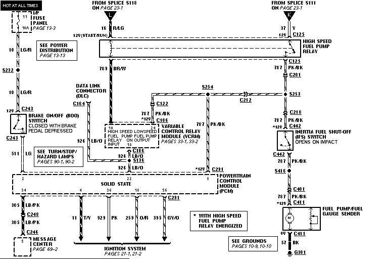

I have been out in the shop all friggin day trying to get the 94 started for my dad. When this all started we figured it was the fuel pump as it has almost 200K on it. after swapping out for a new unit, I went to try and start but the same bull went on.
Next, I moved on to the custom PCM harness that I had to fabricate for the 5-speed intall, that is all tight, and right. I am getting momentary ground at pin 22 on the ecm when I 1st turn the ignition (to prime the fuel system for start up), but nothing else. If I take the fuel pump relay out from the underhood box, and jumper the terminals I can get the pump to activate on high speed only, and the car will start just fine.
After looking through my 93' electronics manual, I noticed that the pump is ran by the VLCM, to facilitale low, and high speed modes. How many people have had a problem related to the fuel side of this module, and COULD this cause a no start problem? And if not, What have been some common issues with this?
Thanks guys.
Mike
I don't have my service manual or EVTM here but I would check/replace both the fuel pump relay and the battery feed maxi-fuse for the same circuit. IIRC, the battery feed circuit to the VCRM is hot all the time. Also the circuit actually uses 2 pins at the VCRM for current carrying capacity.
Verify fuel presence or absence with fuel pressure guage on the fuel rail.
Do a 'wiggle test' of the cam and crank sensor connectors as well as you may be chasing a ghost.
Would'nt be the inertia switch because I can jump the contacts under the hood and make it run. I have power on both sides of the maxi fuse with the ignition on, which means it is good. I also swapped the relays position for position and still nothing.
Thats why it points me to this module.
any ideas?

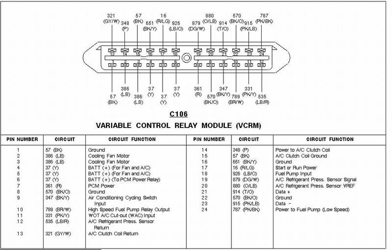

As much of a PITA it may seem, the best method to test a VCRM is to swap it out with a known good unit(say from the '95?). If it still fails to run, an open circuit is most likely.
From what I understand of the VCRM, the fuel pump output is normally a pulse-width modulated voltage. You can test pin 24, circuit 787(PK/BK) for voltage. Also that circuit will have 12VDC when the high speed fuel pump relay is energized.
So, your saying pin 24 should have 12V+? with the ignition on, or when the high speed relay kicks in?
I would also like to know, WHERE does this relay get it's ground signal? is it from the pcm, or the VLCM?
Pin 24 will have a modulated voltage signal until the high speed pump relay is energized. With the high speed pump relay energized, pin 24 is essentially back-fed +12 VDC.
The high speed fuel pump relay is grounded via the VCRM pin 10.
You may be onto something as far as the ground. Check circuits on pins 1, 8, 16 and 22 for continuity to ground. Of course also check ground G101 on the LH front of engine compartment(just under plastic cover with headlight access doors) as well as G104 on the RH front of the engine compartment.
If you have the EVTM, see sections 33-1 and 33-2 for a better mental picture of the VCRM circuitry.

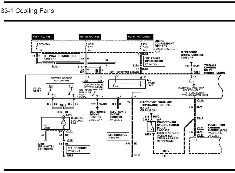

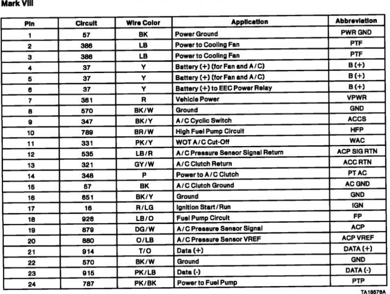

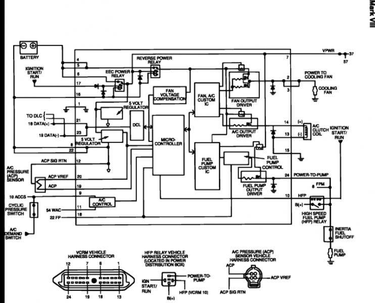

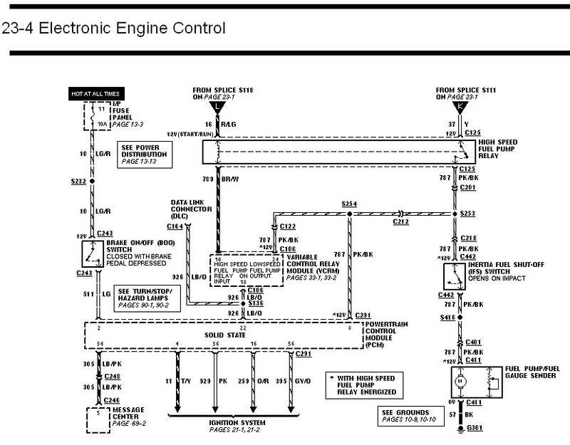

Here are some of the EVTM pages from the 93 manual, and the text from the Fuel System section of the mechanical part:
The electrical system has a fuel pump control relay controlled by the powertrain control module (PCM) 12A650 which provides power to the fuel tank sending unit and pump through an inertia fuel shutoff switch, which is normally closed.
The electrical system provides power to the fuel tank sending unit and pump through two relays: Variable Control Relay Module (VCRM) and PCM power relays. The current path is dependent upon the operating condition(s). When starting and when engine fuel demands are high the fuel tank sending unit and pump electrical supply will be at system voltage. At other times, voltage will be reduced.
When the ignition switch is in the OFF position, the contacts of both relays are open.
When the ignition switch is first turned to the ON position, the PCM power relay is energized, closing its contacts. Power is provided to both the fuel pump relay and to a timing device in the PCM. The fuel tank sending unit and pump runs through the contacts of the fuel pump relay. If the ignition switch is not turned to the START position, the timing device in the PCM will open the ground Circuit 57 (after approximately one second). Opening the ground circuit de-energizes the fuel pump relay (opening its contacts), which in turn de-energizes the fuel tank sending unit and pump. This circuitry provides for pre-pressurization of the fuel system.
When the ignition switch is turned to the START position the PCM operates the fuel pump relay to provide fuel while cranking.
After the engine starts and the ignition switch is returned to the RUN position, power to the fuel tank sending unit and pump is again supplied through the fuel pump relay. The PCM senses engine speed and shuts off the fuel tank sending unit and pump by opening the ground circuit to the fuel pump relay when the engine stops, or is below 120 rpm.
VCRM 1:
VCRM 2:
EEC 1:
EEC 4:
Ignition 1:
