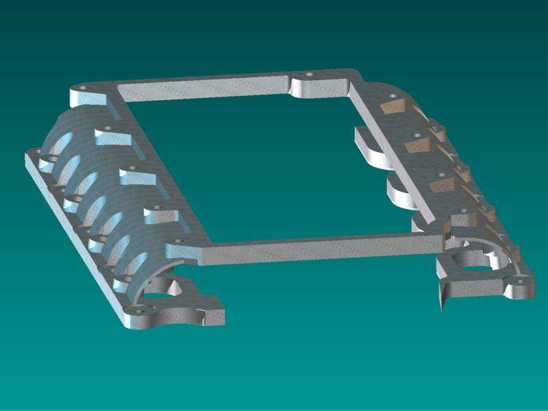

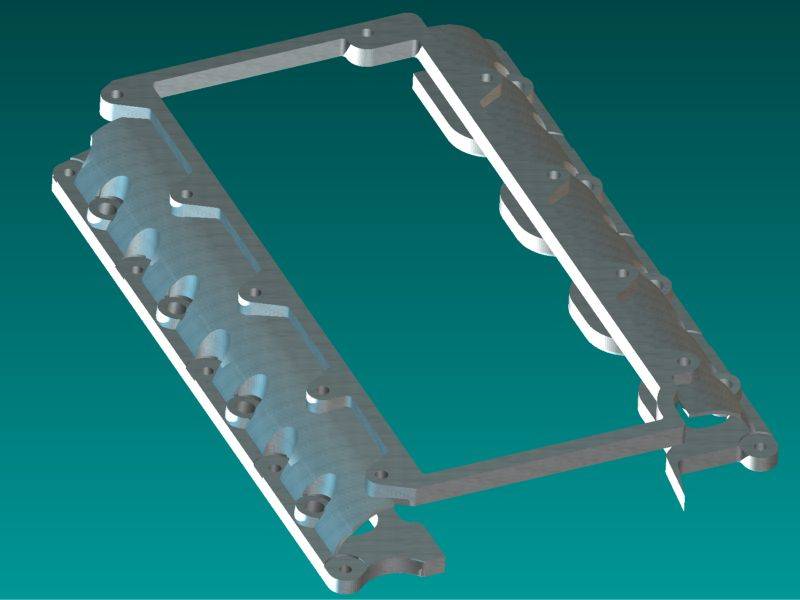

if he could make an intake that would mount to our heads and allow the oem ford eaton to go on top that would be super. better yet the kenne bell down the road. Would be cheap way to boost the mark.
We have a winner.........
I would'nt say cheap tho........... Cheap*ER* maybe.
LOL there is a reason behind the madness ;)

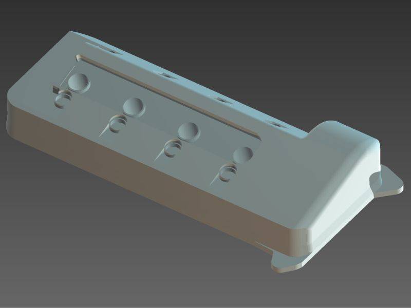

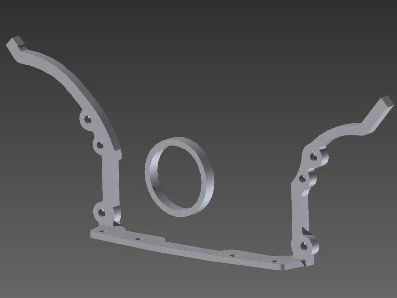

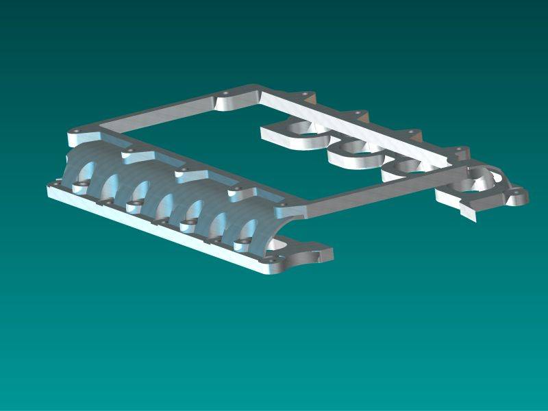

Done for the night................ Started on the front Cover, The remainder won't be finished till I have the Heads done.
Mike

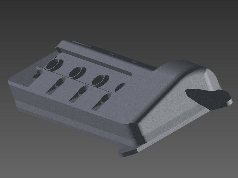

Thats ok Chicken I have a set of COP covers comming for the project.

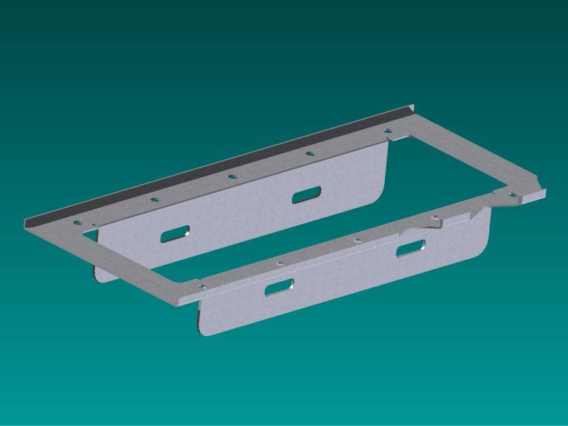

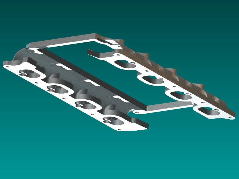

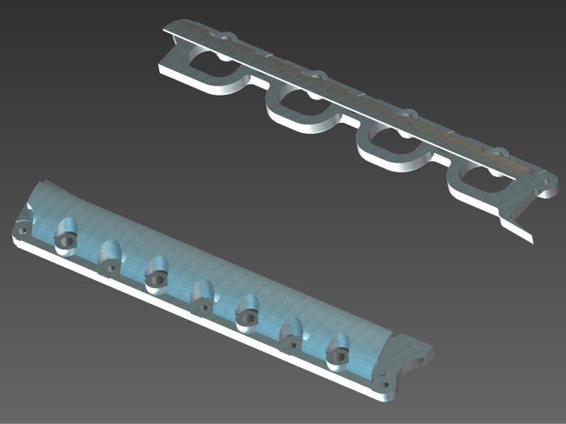

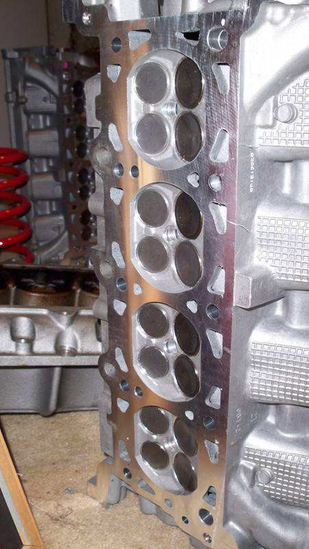

Little update for you folks. B heads won't work for the eaton setup. The intake mounting flanges on the heads stick out too far to fit a sheet metal intake between the heads and still have the cross section to flow the air that I am comfortable with.
Instead I have gone ahead and started buying the parts required for a factory induction system from the 03 cobra. I'll be running a stock pullied eaton for the break in period, but once the bank account recovers, Twin screw whipple is the direction i'm leaning.
The short block will be an MMR900 Bored 20 and stroked using my spare Teksid Block. Transmission will be a Tremec 6060, with an auburn/3.23 gears in the back. I'm waiting for my Oil-lite bushing material for my IRS, and poly everywhere else.

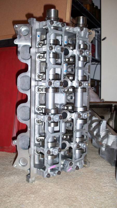

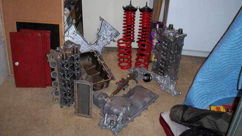

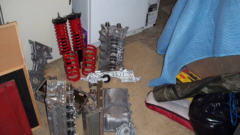

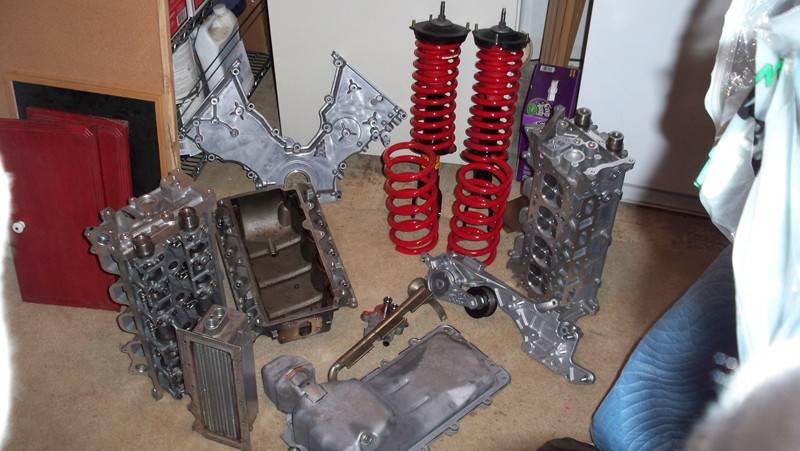

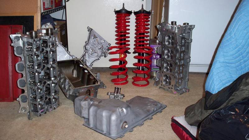

Here are some pics of the parts I recieved yesterday. My S/C and the rest of the induction system will be here in the next few days. The Cylinder heads are being taken uptown to a shop to have the combustion chambers and valve faces ceramic coated, and a light port and polish performed. I'm not sure about the cams though.
I'll be at least going 03' cobra stock, but really want a set of aggressive blower cams. I'll have to talk Stacie into that.
Mike

I wish I could have, trust me.
It'll be better this way anyway. C/Terminator heads flow better, and I don't have to worry about making the intake correctly. Ford's Engineeers have already done that for me.

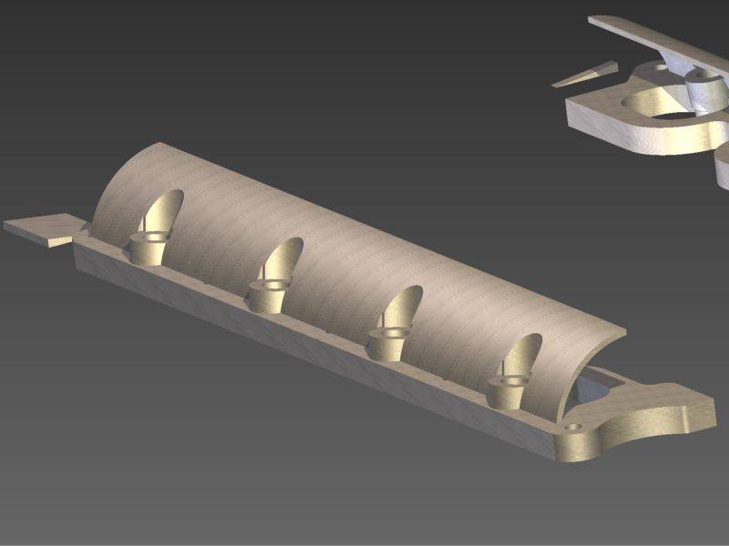

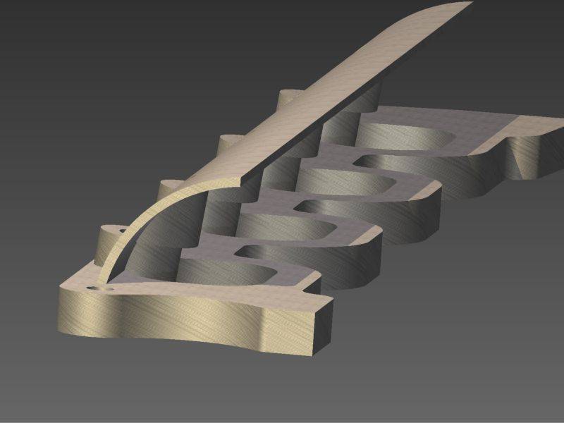

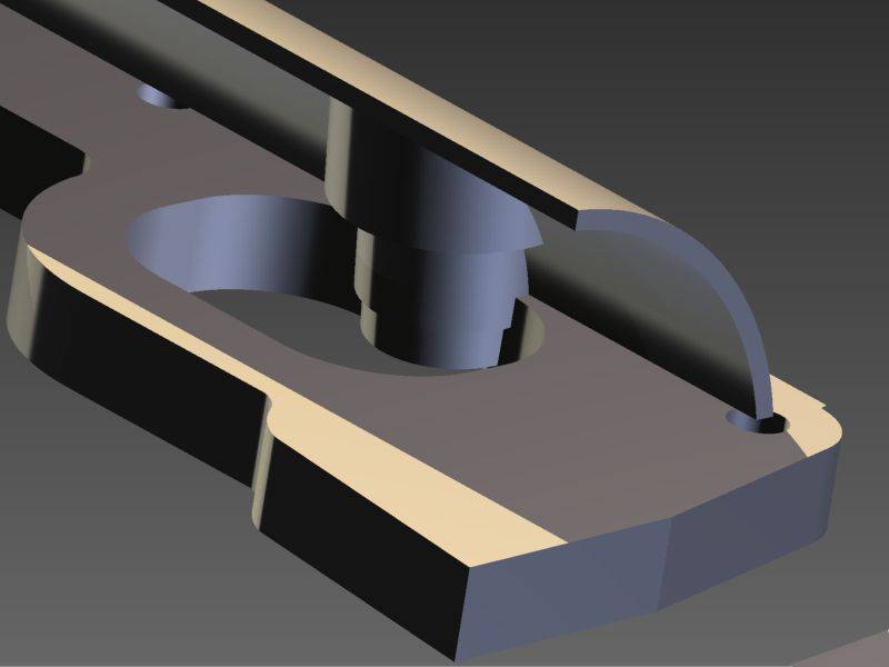

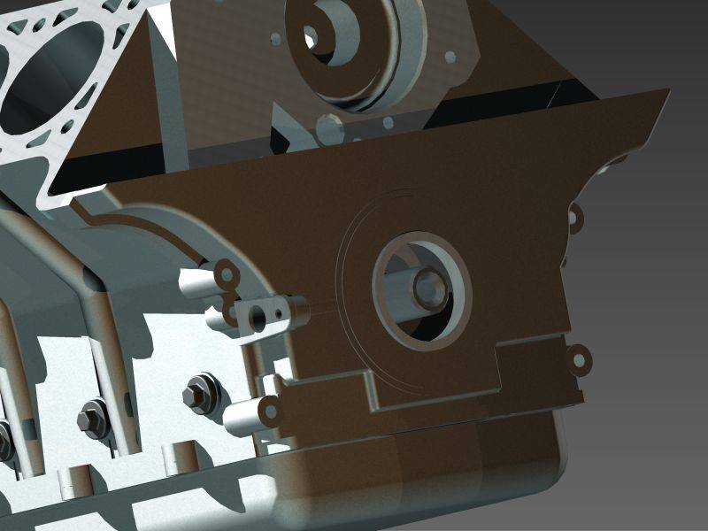

In the little free time I'm still working with Inventor.
Anyone know what this is?

I'm not sure.
I'm running dual 4400 pentiums with 2 Gigs of ram. Not nearly enough ram for what I want, but I don't want to pay for new sticks yet. Iv'e only over run my capacity once, that was on my intercooler core. The file ended up being 56MB compressed and stored.
While open I was on the verge of shutting the pc down from instability.
I'm not sure of the system requirments between regular AC, and Inventor.

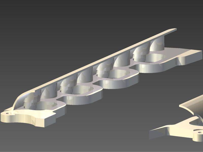

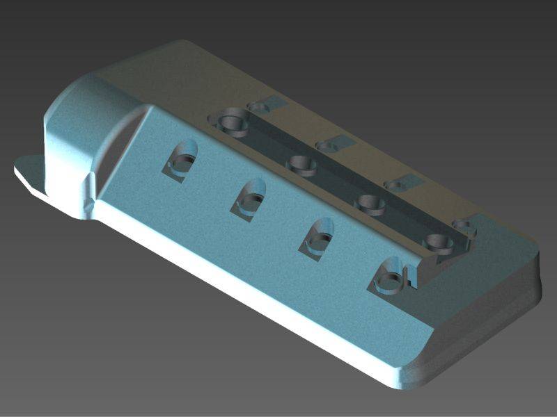

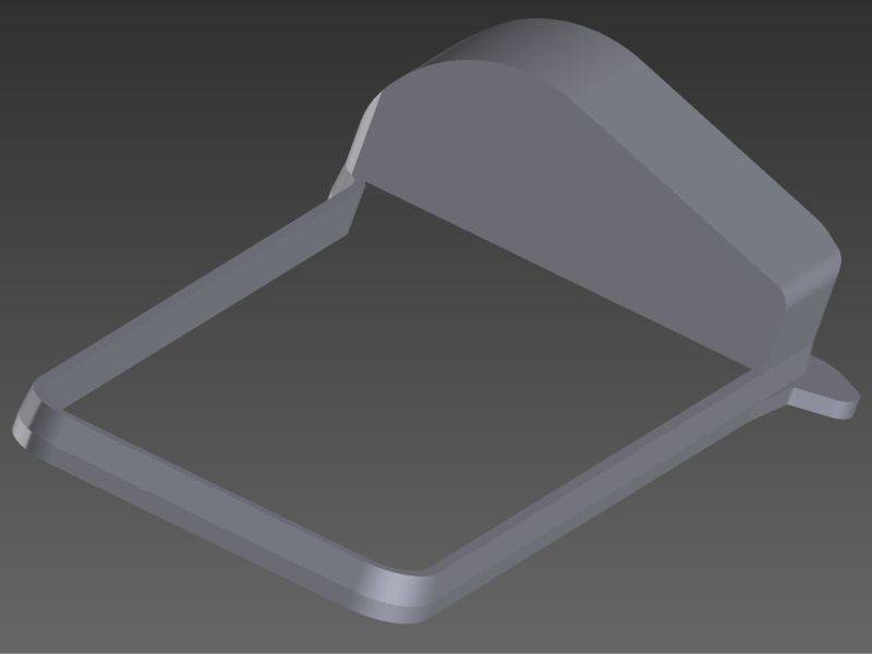

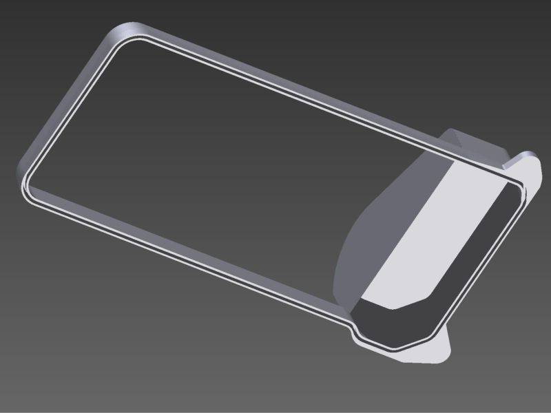

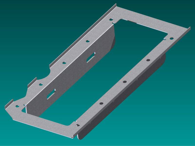

Here is the intake after a couple of hours today.
Mike
