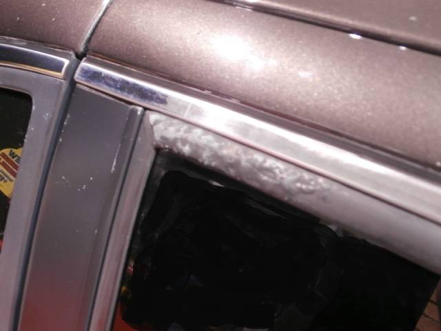

Didn't you say that the molding around the window is bubbled out? If so, that's your noise. My friend's 97 has the same annoying whistle.
yes, both sides

what caused the noise? did you do anything about it?..it's driving me nuts...sounds like a window is cracked open..ONLY at or above 40-45 mph, very predictable hissing...I decided to troubleshoot by masking over anything that looks like a gap in the seal around the windshield
I told you what it was in post 7. To make sure I'm right, go to Home Depot. They have silicone that you can peel off. Seal the window where that black rubberized molding is corroded. Test it then remove the silicone. I've been down this road.
i took the quick and dirty route...just taped over the corroded runners...both sides;
I thought that this knocked it down a bit, and caused it to begin at a higher speed, but it's still there
