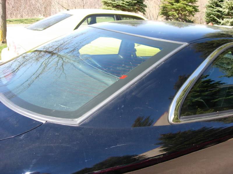

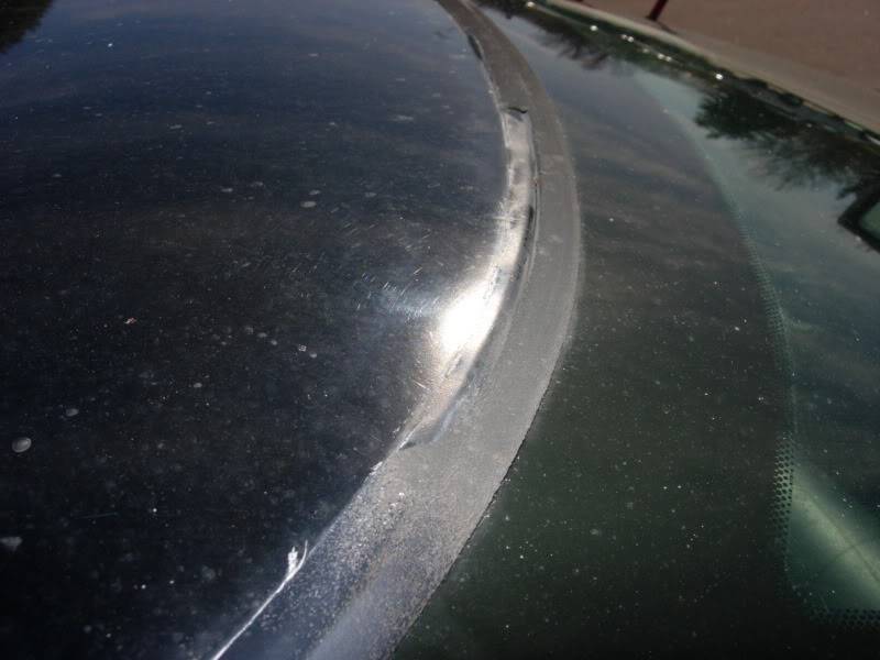

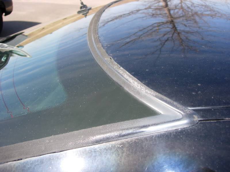

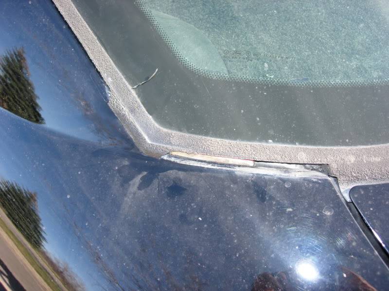

Worse then lasagna.
I had no idea it was causing the cabin noise.
Noise was gone when window was replaced.
yea, my rear window molding looks 10x better than that...I have some lasagna on sides near top, but that's it...nothing cracked or missing...

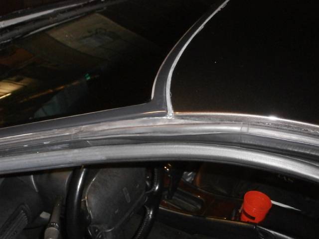

yesterday I went by the local Ford stealer collison center; I explained my issue and he pointed to the drv side weather stripping...when I open the door, it looked like this (normal)

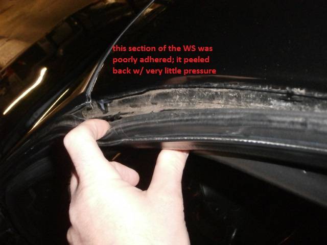

--then he discovered that
so the deal is, when I got up to a certain speed (about 40 mph), that was enough force to pull the WS back right there along the curve, and that created the cabin whistle...
so last night I Goop-ed it back onto the body flange, taped it down, and now it's all quiet inside again! (except for the dual 2.5'' and the FM 40's
