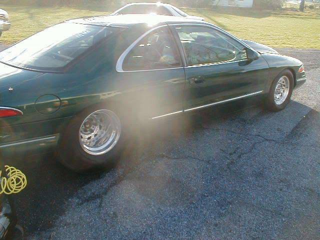

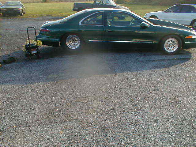

Buckeye: How much rear tire can be crammed in the rear?
98LSC with 315/35/17 M/T drag radial

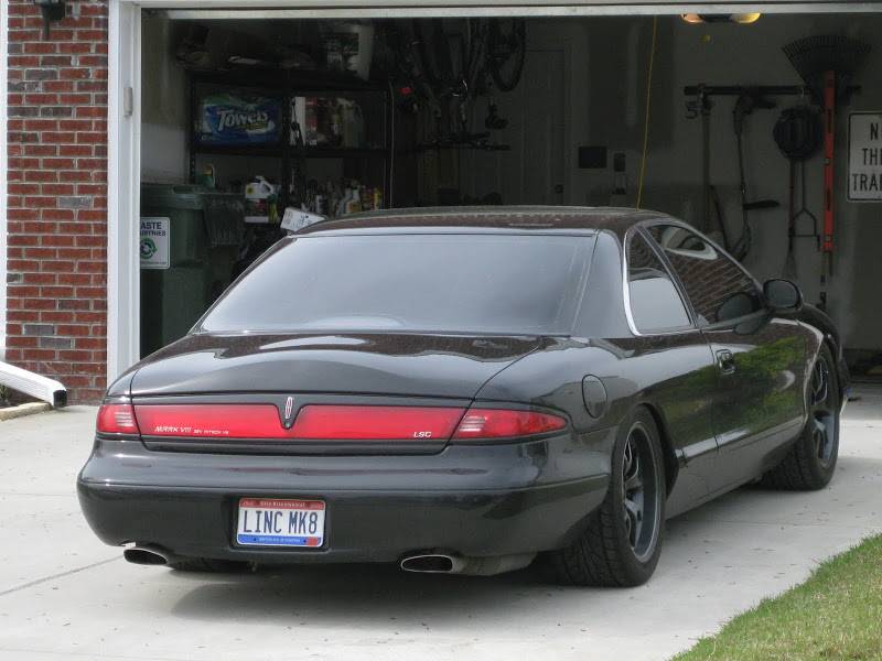

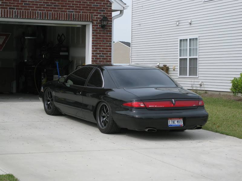

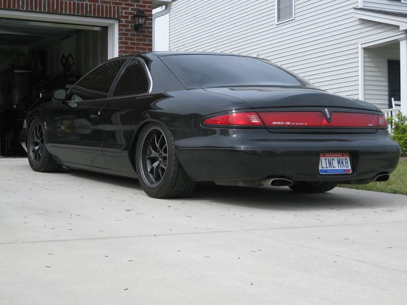

I think that should work alright. Mine are 18x10's with a 40mm offset and 285-40/18's. I did have to roll the rear fenders though....
There was a lot, until I rolled the fenders. I also trimmed the top bumper mount, and rolled that area also. It helped a lot. Occasionally, on a traffic circle ("round-about" to some people) near my house, if I take it really fast, I'll hear a small amount of rub because there's a very large dip and at the same time, I'm changing from turning right, to turning left. I probably need to do a little more trimming on the passenger side.

Here's some pictures of it with the Ray switch activated, and the last one is the only picture I could find somewhat from the side. It was before I rolled the fenders, so I had it sitting a little higher.

That's the same size tires as I've got. I think that should work well. I did have to tie back the e-brake cables though.

Than looks nice, the tuck is great. the amount of tire is good. Just worried about that 2mm difference and the body mods that are needed. I have access to a roller but the bumper thing concerns me a little.
I wouldn't worry about the bumper trimming. I didn't want to do it either at first, but it became obvious that it's necessary, and will not affect anything as long as the remaining mount holes are intact. Many people have done it without any ill effects.
Also, with the 42mm offset, your wheels will actually sit more inward to the wheel well. I think Jeremi told me that the ideal offset for a 10 inch wheel would be about 45mm. I'm doing well with 40, you'll be fine with 42.
