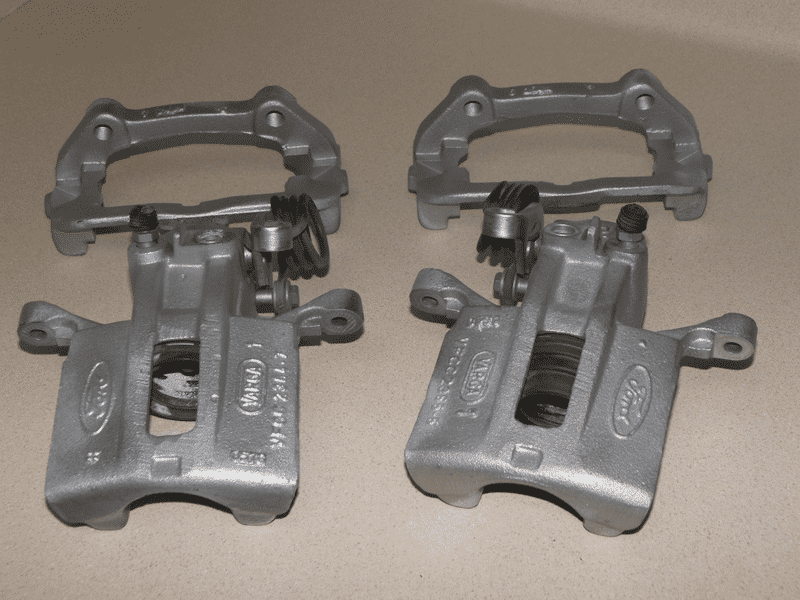

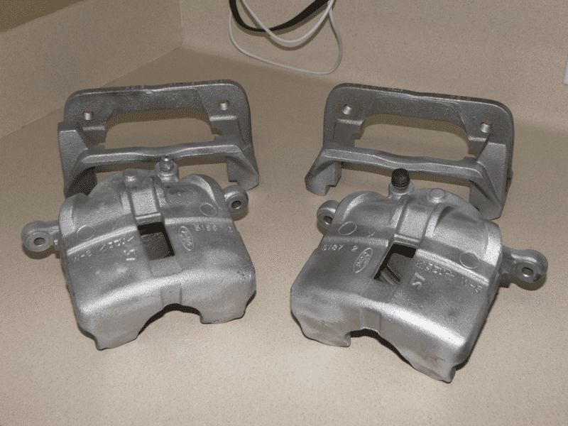

I media blasted the calipers off my parts car. Going to drop these off to the powder coaters in the morning.
Now you are gonna want to blow them out and replace the piston seals. I hope you sealed the brake line holes before blasting them or chances are high they will never work again. :(
