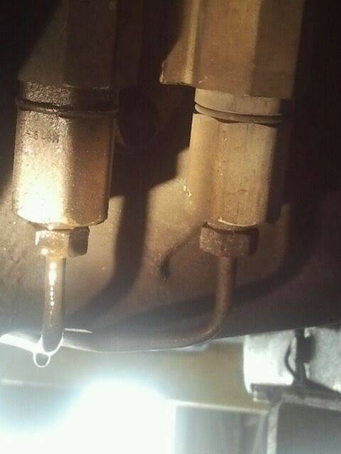

my car has no brakes. its leaking from a bypass valve that apparantly you cant get anymore. anyone? anyone ever bypass the check valve?there are two one for each side in the rear.

All Mark VIII's have those.
That is where you connect your rear brake lines. It is located in the front left wheel well. I should know, I just replaced rear brake lines on my 98 and 94.
Are you sure it's not the brake line leaking?
all mark viii have what? iv got three conversations at once. yes my brake lines are leaking. pedaln went to floor, no fluid in resevoir. i never heard of check valve on rear lines if thats what your referring to. i didnt see it the mgr at midas took pic and showed me. then sapp started talking about cruise and i got completely lost. its on the 'what did you do today' thread. he says theyre almost the same. aaaaaarrrrrggggghhhh!![]()

the picture you posted above is NOT a pressure switch.
I'm talking about the twin brake proportioning valves in your photo. I wouldn't call them check valves.![]()
fixed
bill is right, they are a proportioning valve of sorts, a few fords with 4 wheel disc brakes have these (i know contours do, they had a recall on them) its to basically slow the rear brakes down. i dunno about completely removing them, could cause your rear pads to wear a little too quickly
