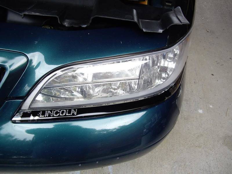

So I felt confident and prepped the trim piece to spray paint it. Sanded with 800 then 1000. One piece of the chrome just did not want to come off and I didnt want to hurt it and my arms were sore cause I had done the headlight already so I said "screw it, aint gonna come out good anyway. :lol: I should point out that I cant paint and every time it sux so my expectations were low. It was worse after I did one light coat and realized I forgot to get primer.:mad: Screw it, I let it sit about 10 min between coats and put 6 coats on it. After I put it together I finnished reading the can (yes I am a tard) and see they want to use clear too.:( So in a few days after it cures a bit I will just glaze and wax it with the professional stuff I have. I also touched up the big rock chips in the bumper.

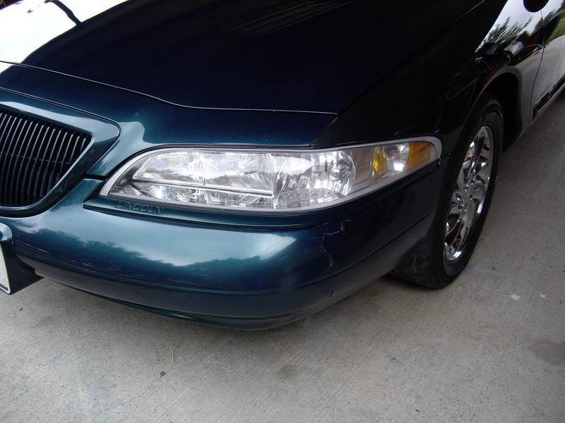

Before:
After:

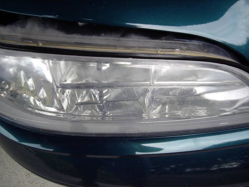

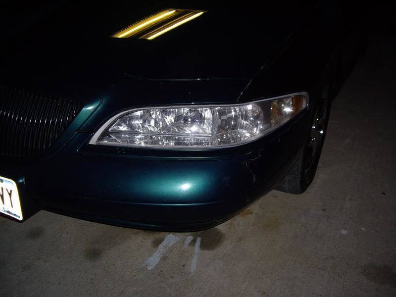

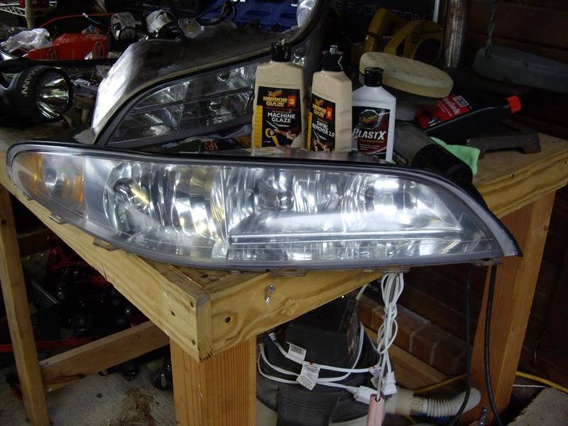

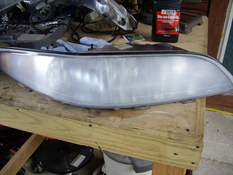

The headlight was also new teritory for me and I followed some advice I read on here. (yes I use the search function sometimes) :lol:

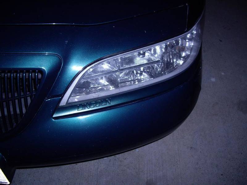

So I sanded them with 1000 gritt untill I couldnt see the haze in the lense and then did 1500 gritt and finnished with 2000 gritt. I then put a Lake Country orange pad on my Porter Cable on speed 3 and hit it with Meguires professional scratch/deswirl product. After that I hit it with Meguires clear plastic polish on speed 4. Still wasnt clear enough so I put on a finnishing pad and used Meguires professional glaze on speed 5 and that got it about as good as I can get it.
So let me know what you guys think. :D
Before:
After sanding:
After polishing. I couldnt seem to get the glare form the chrome reflection down in the pics. Plus it still is not as nice as my drivers side that has a new lense on an old housing. I need to find a new passenger lense and a new drivers side reflector as mine is spotted and pitted.... yet the passenger sides reflector is perfect. :confused:
I will take some pics tomorrow in the daylight so I can really see how bad the mis-match is. With the light on it it looks pretty damn close but daylight will tell all.
Looking good!!
You will probably need to use a more cutting compound to really get any effect with a DA... go buy some Meguiars 105 and 205...
Really? Cool! I will try that. I need to order another orange pad though cause mine is shot. So do I hit it with the 105 then the 205 and then polish it?
I used the $20 Wal-Mart kit and my drivers side came out great, passenger not as great but usable.

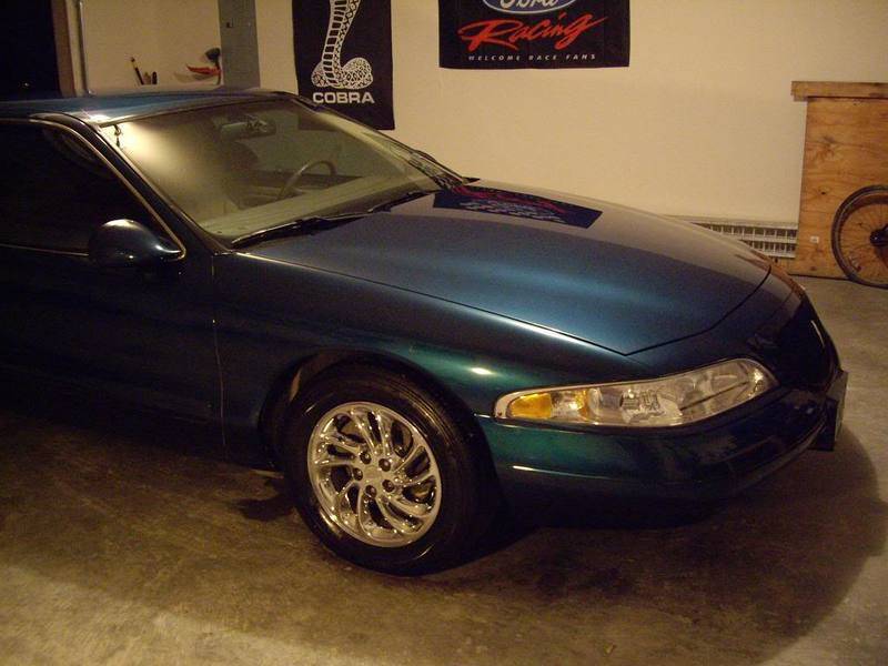

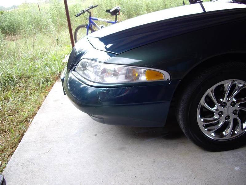

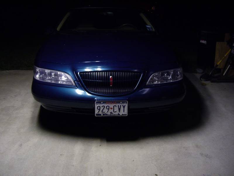

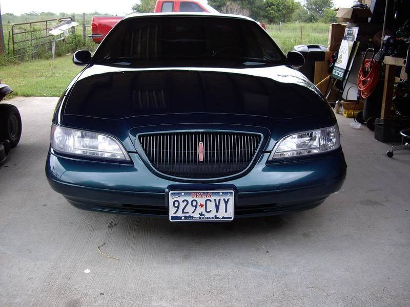

Anyway, I took some daytime pics to see how it blended. Its no where near perfect but its a ton better then before.

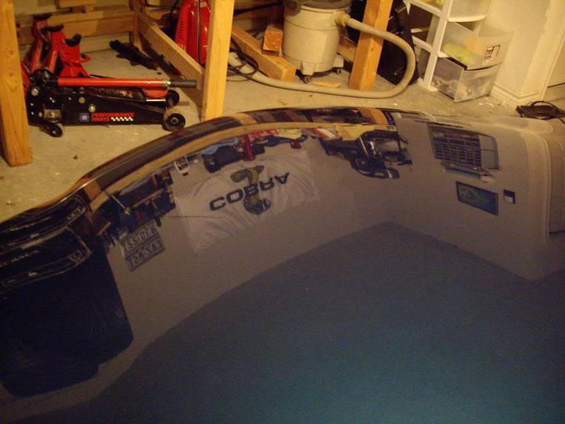

In this pic you can see the deep large scraped on the drivers corner of the bumper.
And this is after I did what I could do:

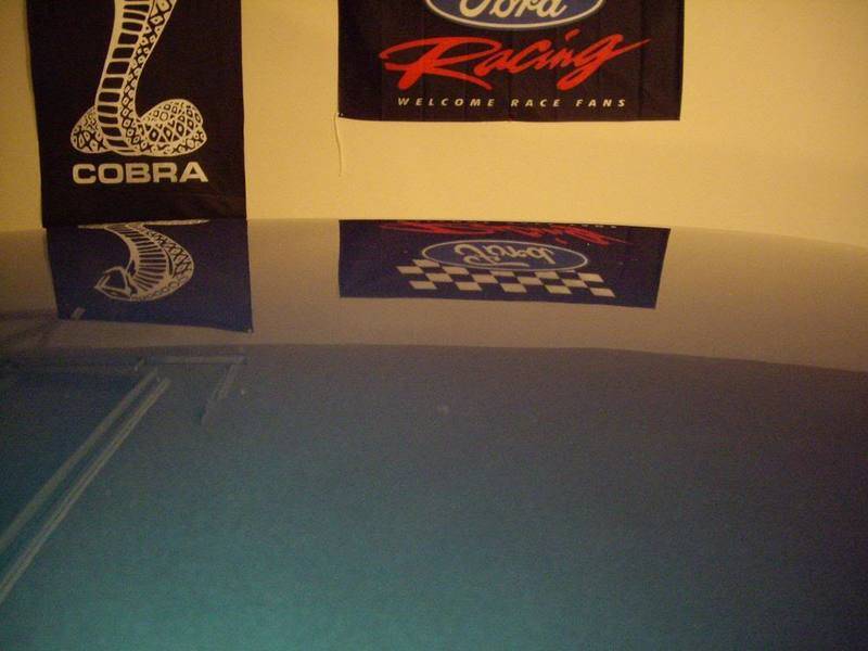

Sure! I read the bottle and do what it says. :p
I use Meguires car wash with a micro fibre sponge. Then I clay it with Clay Magic and use Meguires instant detailer to keep it wet. I then hit it with Meguires machine swirl remover on a Lake Country orange pad with my Porter Cable set at speed 2.5 then up it to speed 3 untill it breaks down. Then I use a foam pad on the PC and use Meguires Professional glaze on speed 3 then up it to 3.5 untill its almost glossy. This step isnt mandatory and it just allows the gloss to last longer and look a tad deeper.
Then I use Meguires NXG wax on a black finnishing pad set to speed 5.
After each step I remove the chemicals with fresh micro fibre towels.
Sometimes after all that I will use my little Wal Mart POS buffer with a micro fibre pad and do a dry pass on the whole car. It makes the car look wet when I am done.
Using those steps I turned this:
Into this
