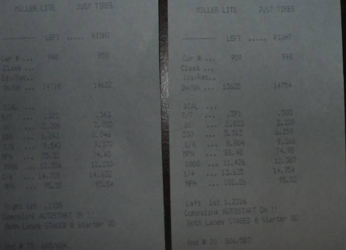

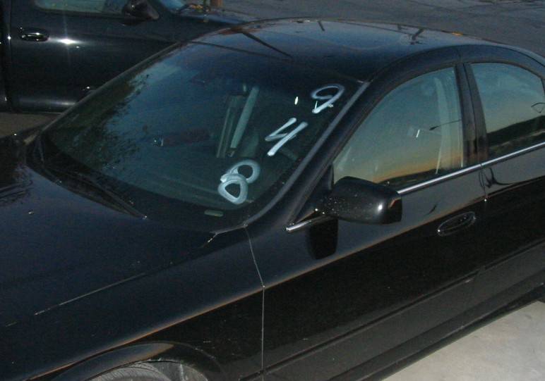

Who has the fastest N/A timeslip for a 00-02. Pulled my 20s and ran today, and she ran fast. Had alot more gas than I needed too, near 3/4 tank.
So what kind of car did you race in that last timeslip that smoked you ?
I ran 13 times, I'd have to think about that.
I got beat by a 99-04 Mustang a few times, a Charger, a Neon. Hard to remember with that many passes.
Wow I didn't know the LS was that fast. I thought it was more like a 15.5 or so. Nice job, now see what you get in your mark But I thought I will be faster then the LS.
Also noticed that the other two races #950 improved his time and beat you the second time around. I bet you up north guys are enjoying the better performance with the cooler temps. Its still in the 80's down here in Florida during the daytime. Sucks.
950...ahhh, yeah, that was a early 90s Integra with bare bondo all over one quarter panel and the whole car was spray can painted, a real wreck. I actually raced him 5 times and he won all but against my 14.5 run. He had slicks and a stick so he could do 2.0 60's, but then Id pull but not enough to catch. My traps were always higher.

I couldn't break 14.9 with 60's in the mid to high 2.2s. Also had some 15.0 and 15.1 passes with 2.3 60's. I dropped the tire pressure from 29-25 and lightened my launch technique and bam, high 2.1 and very low 2.2s 60's. Went down to 23 and it seemed the same.
The launch is the secret. You can almost make a multiplier for the 60' to get the 1/4 time with a very small margin for error.
Running the car 13 times all in one day helped me discover how the car likes to leave the line and how it doesn't.
That said, taking what I've learned, less fuel, my K&N is real dirty so I'm cleaning that, if I can get a low 2.1 60' I figure a 14.4 @ 96 is possible with no further mods.

Wouldn't be a secret if I told you. JK
You are right, I've noticed the car doesn't like a hard launch. As a matter of fact it almost seems to bog after the hard launch around 3-4k. So the rpms jump from the launch lag 3-4kish and then kick in hard, not very smooth.
I've noticed in the past with my 20+ previous passes and found a light brake launch was best, but didn't really master why.
This time I ditched the hard launch early cause I knew it didn't work well but figured it was worth a try with my lighter wheels. Well traction with the stock Michilins isn't as good as the Nitto555s either.
I then found that the lightest possible gas/brake seemed to help that lag and produce better times. I then started to not slam the gas so hard to the floor. This is very hard to control, I've hurt my foot racing before. That seemed to eliminate that lag all together with a smooth fast rev right into the power band, no lag. I can actually feel it and see it in the tach.
I use the SST, you have to start in D5 and move it over immediately after launch. If you move it over to late it will shift into 2nd when you move over. I had a 14.9 pass Sunday with a 3kish 1-2 shift.
Sooo. 22-25psi, hold the brake and touch the gas just lightly, last yellow put it down but not to hard, move the shifter over, look down to the tach cause its time to shift:D.
