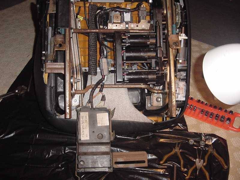

I'm not exactly positive where that part is but I do believe it's either under the seat or inside the door panel. Seems like it's under the seat and the auto down module for the windows is in the door panel. Either way, I'm almost 100% positive you either have a bad connection on a harness under your seat or the memory module has went bad. Maybe disconnecting the battery and resetting the PCM might fix it for you. Hard to see the module going bad from just setting. Anything is possible though.
Hanging there to the bottom left.
A bad memory module will make the seat and mirrors not work there is a reset button on it if you can get the seat to move it is on the back of the box it's a little white button. When mine went out the seat was all the way forward and when I could not get the seat to go back I started looking around, low and behold I find this little white button that makes the seat go back to it's original location

That photo is from a 94 seat. If yours is a Gen 2 it's in a different spot under the seat. It's a little harder to get to, but I think there is a fuse there somewhere, I forget exactly where.
