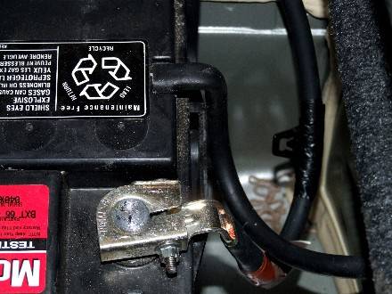

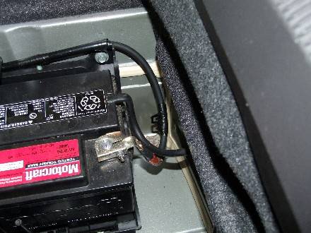

The top of the photo's is the passenger side and the right of the photo's is the end of the car:
thank you very much for the pics, it really does help, but at the same time i see that i'm screwed since i'm positive i used the dynamat right over that spot. do you know if they sell the hose by itself?
It would probably be easer and cheaper to find hose at a home improvement store. I know both Lowe's and Home Depot have different size hose sold by the foot.
