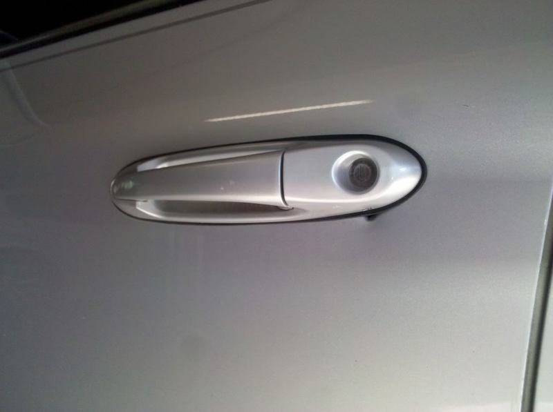

Hi everyone,
So I was out smoking a cigarette on break here at work, and noticed this on my driver door (assuming this happened over the weekend at my house):
They jacked the metal up pretty good, I'm just thankful they didn't get away with the LSE.
Are these cars easy for dirt-bags to steal? Are there safety mechanisms in place as far as the ignition is concerned?
Looks like I'm going to have to get the garage cleaned out ASAP.
Thanks,
Apparently, it wasn't too easy.
Yes, PATS will keep them from hot-wiring the car. The perimeter alarm should sound if they do break the door open.

The perimeter alarm will NOT help you if the guy was able to finish what he intended to do. He intended to pop the door handle, which will easily allow him to move the rod that's connected to the key cylinder. If he lifts the rod up then it would be as if the key was turned to unlock the door and turn off the alarm(and if he holds it up all the windows will lower). The door handle is plastic and a thief can easily break off the mount, plus the key cylinder is not mounted to the door(like it should be), but to the door handle so that when the door handle is broken away, it can easily be moved to unlock position.
You can easily add shock sensors to both sides (very cheaply)that will work with the factory alarm.
