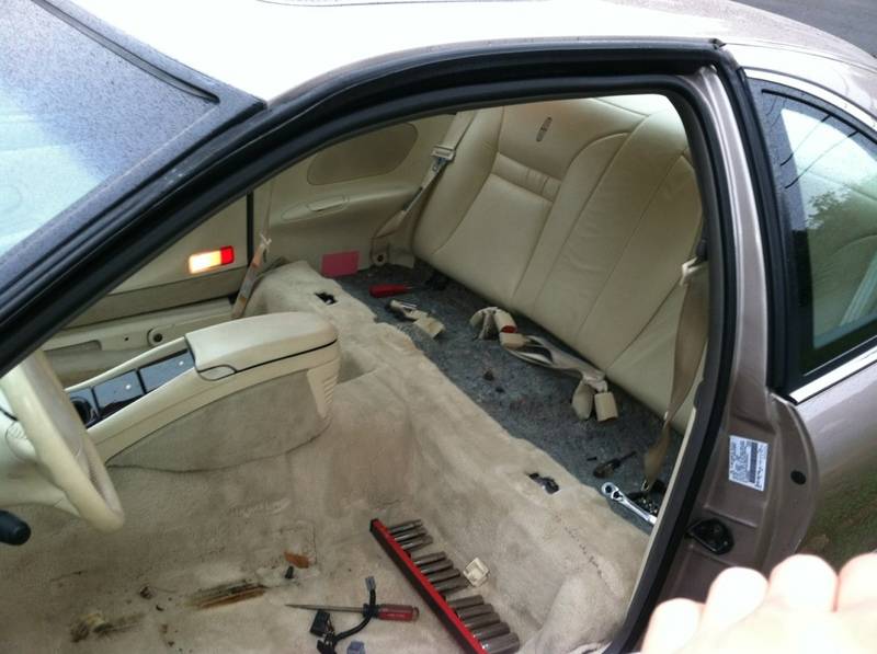

yep, as soon as i posted the thread i got off my ass and started tearing down the interoior... cant put it in the sun because its going to ran for the next 4 days :(

UPDATE!!!!
seats center console and carpet are out. drying carpet in my room now :D
thanks guys!
UPDATE!!!!

i dont think i will have too much of a problem. after i pulled up the carpet i realized how non sever it was. there was no water threw the carpet. and the underside of the dampener was dry as a bone :D
carpet is already dried out. so all in all i learned how to remove the interior. :D
