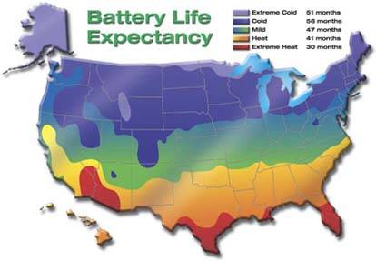

cableguynoe said:
Could it still be something in the battery, starter, or alternator?
the battery could be gone - it does last as long as most people think....
