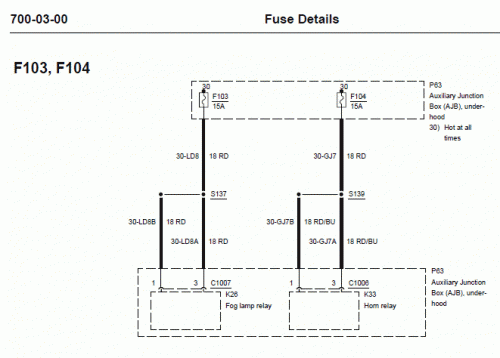

Short to ground on the "negative" wire, or defective FEM.

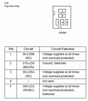

Check the relay. I had that happen to mine and turned out to be the relay.

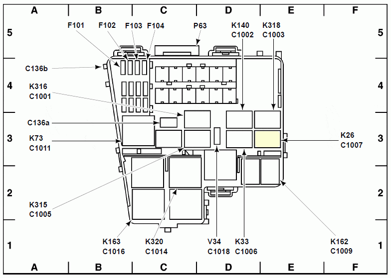

Yeah, forgot that the fogs had an external relay. It's number 7 under the hood fuse box.

Relay K26 ~ Connector C1007
