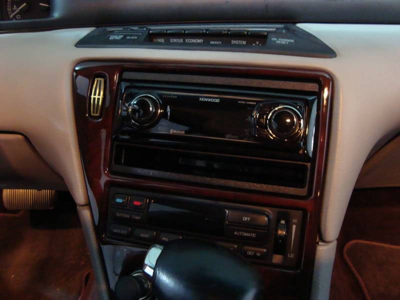

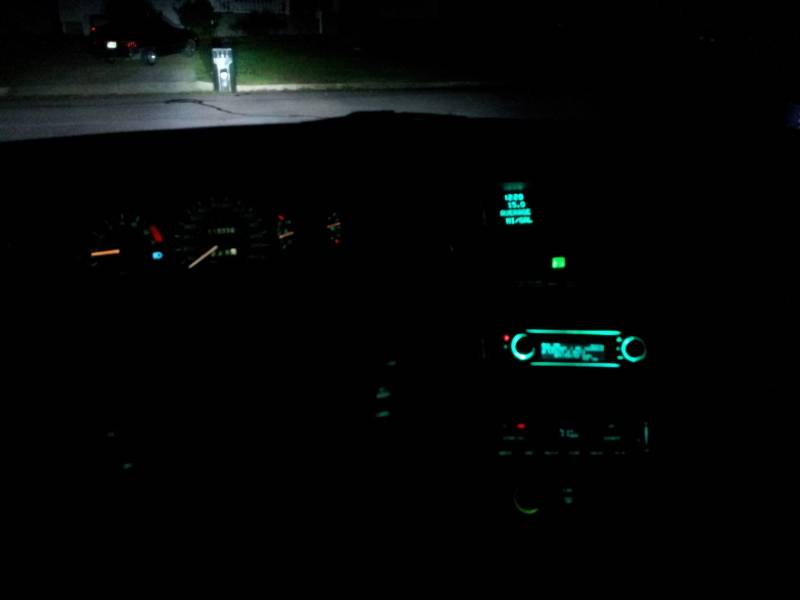

Kenwood eXcelon KDC-X993 also lets you change colors to match any dash lighting. That's one of the reasons I bought it plus the other options that come built in. Diesel Dan has the same HU that I have and he loves his too. It answers the phone for you and that can be set to answer it within 5, 6, 7, 8, 9, 10 seconds after it starts ringing. Has many many setting for a single din HU.

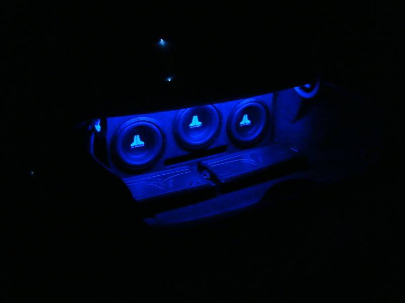

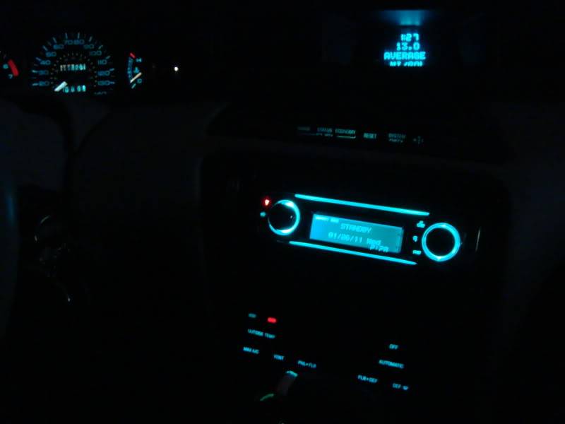

This is a night time pic taken by phone. Not a very good pic but the phone wasn't set for night settings.
Another night shot
Daytime shot

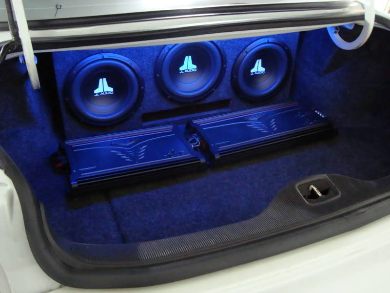

In the trunk
60 blue LED strip connected to the trunk light harness, so when the trunk is opened, the strip comes on just like the normal light would.
Everything completely rewired. JL Audio 2-way's in the doors and Kicker 6X8 2-way's in the rear. I rarely ever listen to it but it does sound good for what it is. My 10 year old plays it when he's with me. Either on Pandora from the phone through BT or the iPod Touch that remains in my console.
That Kenwood looks good in your dash. Too bad you can't mount those amps on the sides of the box.Looks good and I bet it sounds even better.
