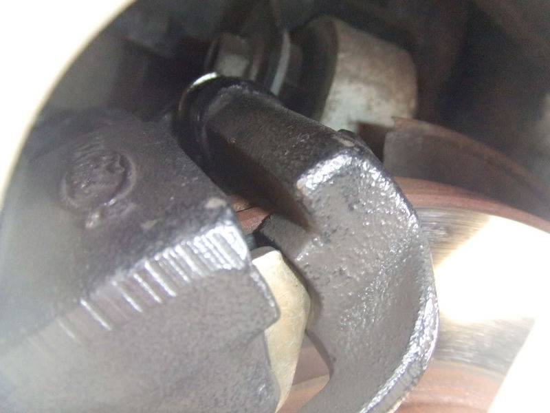

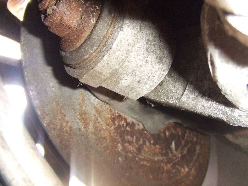

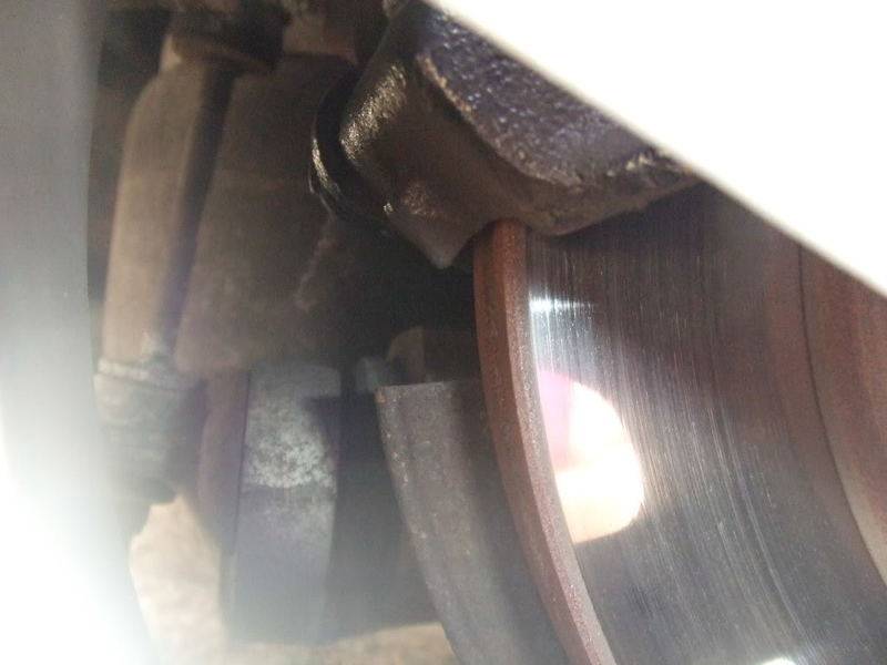

Pads aren't lubed, sway bar bushings are shot...bout all I can see...take wheel off and take brakes apart and lube the tips of the pads (the metal part) where they make contact with the bracket, and the backs of the pads (pads should have shims,I they didn't come with shims...stop buying cheap pads)...and the guide pins

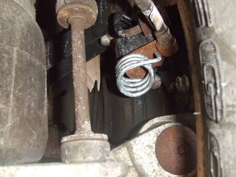

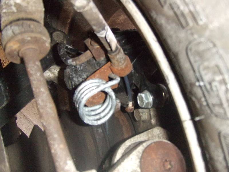

Get pics of the pads, both friction surfaces and then hold the friction surfaces together for
both sets, and the rotor....but factory rotors are near discard when they are brand new...best to just change them
ill get those photos when it warms up and i can do some work on her. (its 15 degrees out side). but im going to replace all the rear bushings. as i think thats the main part of the problem.
I would say it's about time for a total bushing overhaul judging by the look in those pics, the arm bushings generally last longer than the smaller sway bar links, and if those look like that, I can immagine what the rest look like. I'll give ya tip if you plan this on your own, you'll need and extra hand to remove the forward bolt in the lower arm to knuckle.
