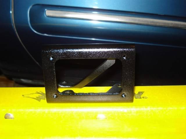

Well, I still wasn't happy with my coil bracket, so I stripped it and did it again using the tips from the people here. Still used the Krylon anti-rust with hammered finish but turned out real nice! (you were right chicken)
Pictures don't do justice, kinda sparkles and looks like new. (was rusty and horrid before) Might do some more 'dress up' with hammered finish spray. There's abit of grey inside there... Was a hard place to access without causing runs. (a run on that part was why I started over) You won't see that when coil pack is back in.
Well, it's meant for garden furniture and other outdoor stuff, so should be good. Plus, it's only a coil bracket. Heat may be a concern, but we'll see. Don't think that bracket will get hot enough, to be honest.
i know i rock lol yeah i like the hammered finish, it looks just a step off of stock, just enough that only true enthusiasts will notice
