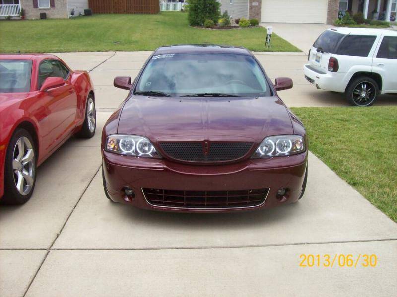

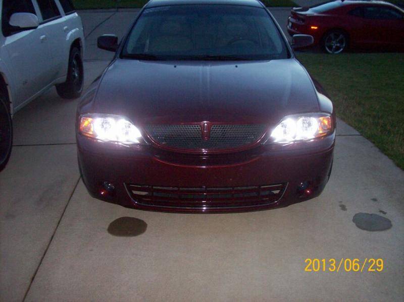

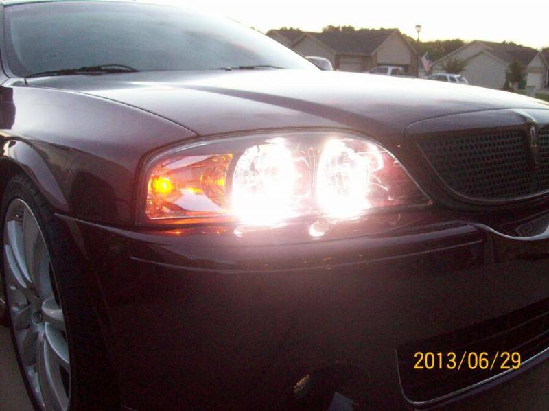

Umnitza kit for the LS. I ordered them directly from Umnitza. They are the Preadator Orion V2. Cost $199.99 and worth every penny. They are bright as hell. Install was easy. I am VERY pleased with them. Pics

+1 ^ Umnitza Angel Eyes are #1 :cool: I recently went to purchase the V2's and when talking with them on the phone they had told me if i could wait a day they would upgrade me to V2.5 which is 90 leds WOW! so glad i waited these things are so bright i can damn near drive in the dark with just them on.

Glad you like them.. I LOVE mine.. I see you have a 2nd Gen LSE bumper now with 1st Gen headlights?? I'm happy to see it fits so well. I will probably buy one too but was never going to buy 2nd Gen Headlights..
Car looks great now!!

I completed the 06 LSE swap about 2 months ago. Did 02 LSE side skirts and rear bumper. Even did 06 mirrors. There was a bit of a gap between the bumper and headlights. Manage to fix the gap.
