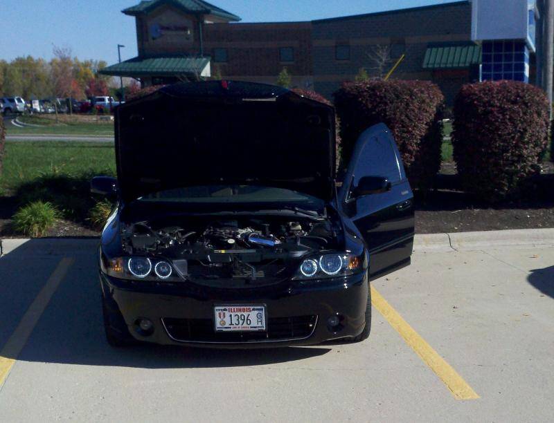

I installed angel eyes and they work but they flash with the turn signals. I have them wired:
The brown wire from the angel eye ballast is spliced to the blue/black wire on the turn signal/parking lamp harness and the white wire is spliced to the black/white wire on the parking lamp harness.
Any ideas?
Here is a pic, they turned out good except for this issue.
