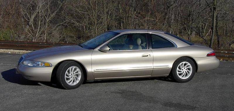

Here's my 97. It's got the American Air Lowered kit installed....
