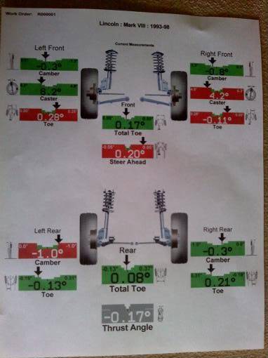

Took the car up to my work on saturday, it was my day off. Usually I hate being at work, but when I am working on my own car, it doesn't bother me. We have a Hunter optical alignment machine. I dont know the model off the top of my head, but its pretty damn accurate. The alignment was good before I replaced the RH lower control arm, and RH inner, upper control arm bushing in the rear.
Before:
I had to adjust all 4 wheels to get it right.

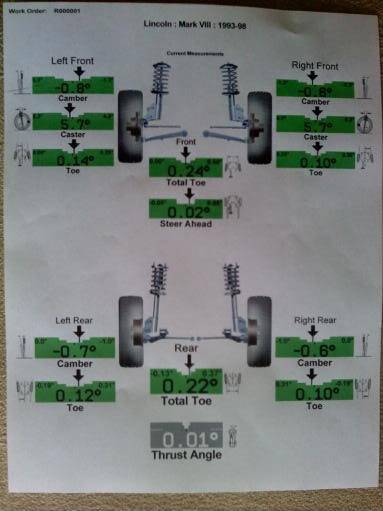

After:
I should have put a split on it, but I decided to try it equal on both sides. Right now it does wander with the road crown on the highway, but on regular roads it tracks perfectly straight. I was nervous putting the split in it first because sometimes this machine is slow to update what the caster is, because it is such a sensitive angle for the machine to measure. The car used to have a lot of negative camber in the rear, its funny how much I can notice now, just by looking at it that the wheels are standing up straighter.
Hunter DSP600. I have also noticed that I don't have the bounce that I thought I felt in the front end. I replaced the rear shocks with sensatracs and there is a specific bump on the road on the way home that makes the nose of the car bounce. Felt like the front shocks were worn out. My car has an original LF bag, and an American Air bag on the Right. Anywho, now when I hit the same bump, I dont get the bounce that I felt in the front, must have been the rear shocks.
