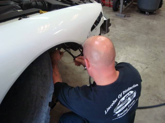

It can be removed that way but removing the front bumper cover helps get you in there a lot better and really check things out. The lines going in are usually a pain to get them loose. This is Jamie installing the new compressor that I sent him before I flew down to buy the car. He tore these cars down daily and it was his choice to remove the front bumper cover to remove and replace the compressor. I'm sure he has his reasons.
Jamie might sue you. Shiny head rights are being violated + he's wearing an LOD shirt!
