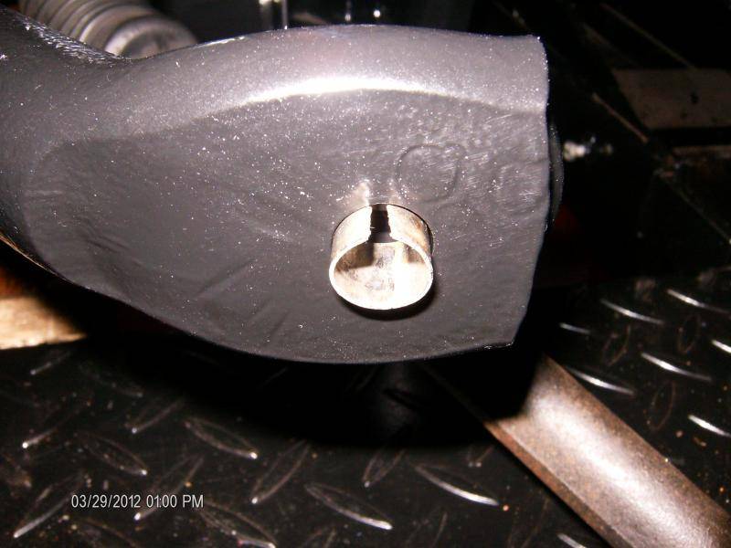

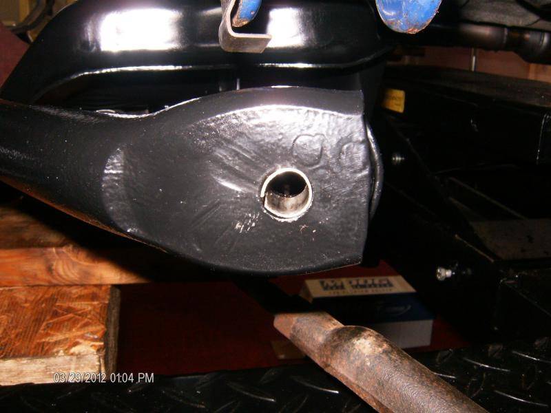

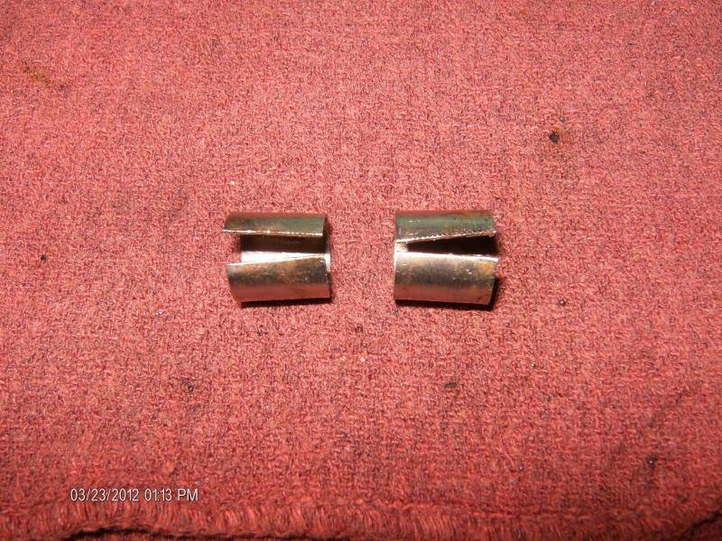

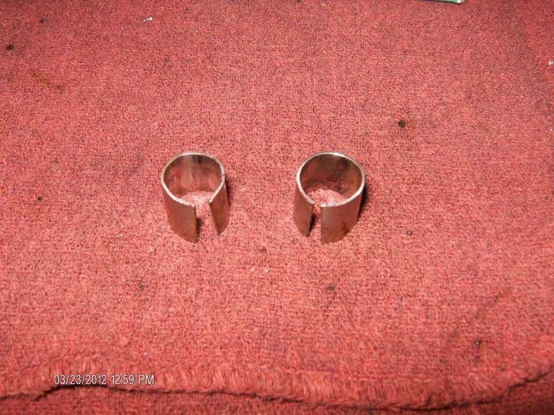

BTW, here's a tip if you have an Addco front sway bar, and the front holes are too large for the OEM sway bar links. And every front Addco bar that I've ever seen has had this issue. :mad:
Use a piece of a stainless steel hose clamp, form it into a cone, and put it in the hole in the sway bar before installing the links. And I'd suggest putting the gap at either 3 or 9 o'clock.
+1 on the Addco front bushings sucking, they aren't even round! I ended up using ES greasebale bushings too, but mine still squeak at times no matter what grease I use :(
I had to do what DLF did with the front end links sleeve as well, even though it was the third bar or so and I told them each time the holes were to big! :rolleyes:

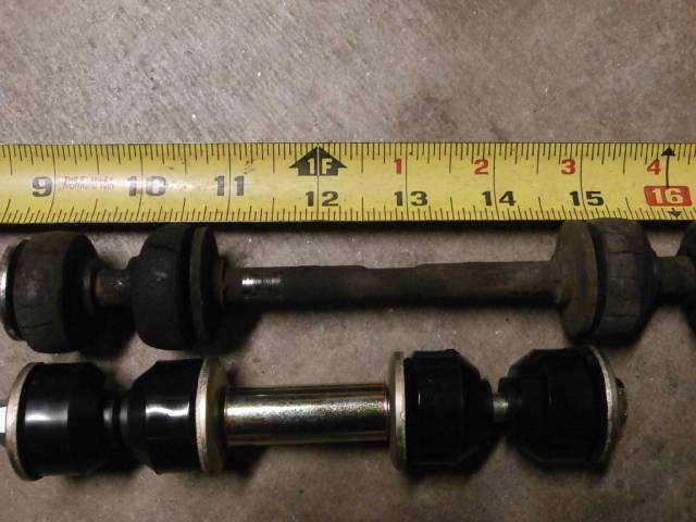

I'm converting to coils and adding and Addco 493 (1.125") rear sway bar...this is the end links that were
sent with it- they're about 2" shorter than oem...does this seem right? I'd read on the mark VIII form that it should only be reduced about 1/2 to 3/4''
my new used coils are 1.5'' lowered and from a t-bird; it may now be lowered less than 1.5'' now b/c I'm using rubber isolators top/bottom as well as a snowflake center cap as a perch
it's running down hill a little bit, I dunno if it's worth adjusting to make 'level'?

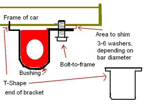

it is/was..hard part was paying the 200 clams for a new Addco ;)..they're often in the JY but may need new bushings? b/c the bar is fatter a couple washers/shims are needed on the front side of the clamp to body
diagram from 'BlackiceLSC' per Mark VIII form
I almost did my rear install incorrectly: I (over) tightened the end-link nuts on unloaded suspension-binding the sleeves, then lowered the car...the next day someone clued me in so I loosened em, drove a little bit, then re-tightened them, I've read that they should not be so tight that you can't spin the sleeve...I definitely noticed a handling improvement on the first test drive...now i want one for my brown M8
