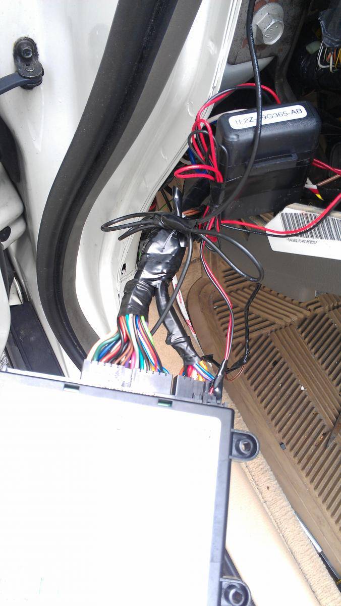

What on earth is that thing? it almost looks like an engine immobilizer. What is the entire number sequence on that control box in the first picture?
First owner was a Ford guys....on the box it says Ford motor compagny remote start system this thing.was made by.ford dealer ....only thing I know...I should be worrie about that thing???
Looks like a mess to me, I'd also get rid of it, return to stock. why'd they wire into COP (Coil over Plug) ?
So that's some sort of remote start? That would mean the remote start is somehow malfunctioning. Unless it never worked in the first place.......
there is nothing with the remote start..... no need to rip everything out. There are two options when installing the Ford remote start (tach or tachless) the reason the wire is connected to the cop is for the tach.(the LS does not have a tach wire, it send the tach via the SCP data wires to the I/C) The remote start module monitors the pluses to the cop and if it goes to high during the remote start feature it will shut the car off. The light was flashing because of the misfiring of the cop. Also, you can change to tachless mode in option bank 2 feature 1 of the programming menu. The other silver piece attached to the hood is to disable the remote start when the hood is up, so the engine can't be remote started if someone is working on the engine.

If you just remove the modules(depending on what system you have), yes it is possible your car won't start. If you have the remote start only system, then you can remove the modules, because it only piggybacks the wiring to the ignition and starter. If you have the remote starter with VSS(vehicle security system) and remove only the modules, you will not be able to start your car because the the starter wire from the ignition is cut and run through the main module for the interrupt feature. As for the programming, there is nothing wrong with switching to tachless mode, because the module monitors the manual(key) crank time(to determine an average crank time) and also monitors the voltage to know when the vehicle started.
that explains pretty much everything ... was wondering why the need to run an auto start to a coil. +1 thanks!
with remote start systems, you need a tach signal so the system knows a) when the motor is running(important if the cars is already running, and you want to remote start it to keep it running when you go into a store), and b) when to stop cranking when starting the car. the most common place to get that is either at an injector or a coil
the item in the third picture is a hood tilt switch, this is to automatically disable a remote start anytime the hood is open.

for the record, some of the worse R/S installs i have ever seen have come from dealer add ons. there is a huge difference between factory remote start and a dealer add on.
You do not need a tach signal for remote start system to work properly, it has the option to run tachless. I installed this system in my brother's 09 Ford Ranger (set in tachless mode) and it has worked flawlessly. The only advantage of the tach mode is if the idle was to exceed twice normal idle, the remote start would shut down. The system also has options to shut down if a door is opened, and will always shut down if the brake pedal is pressed down without the ign, key inserted & turned to run. The system also has a quick stop feature that allows you leave the car running when you go into a store.
no. you are correct, it is not actually a requirement for remote start (aftermarket systems on manual transmissions require it). But while there is tach less modes for most brands, I would always prefer there be a real tach setting, as i have seen a lot of issues from tachless starting that were resolve from simply running a tach wire.

I would counter-guess that the remote start processor was crashing and resetting due to RFI noise from the misfiring coil(s). Of course, that's just a guess.
