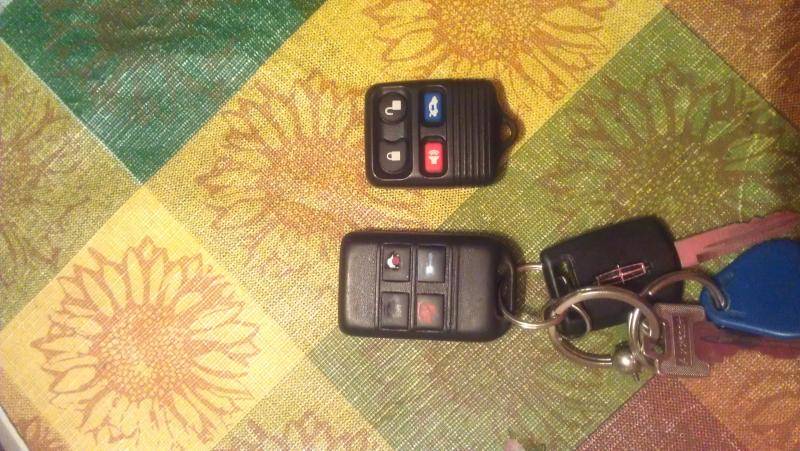

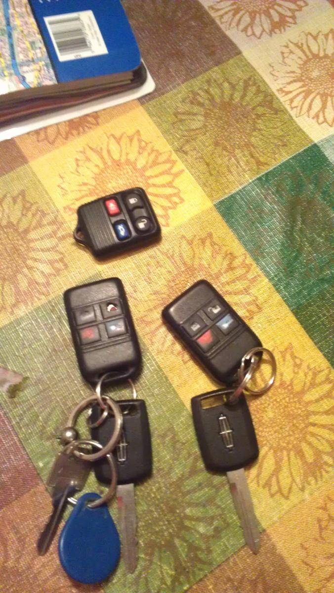

also take a pic of your alarm key remote is it aftermarket or the ford OEM that will tell you if you are actively using the aftermarket alarm or not.
alright next week I will find a aftermarket guys who can chek my car thursday or friday so stay tune imma going to give you news and tell u if it clear my problem ...thanks a lot all you guys for giving me all that good information appreciated and ill try to give you picture of my remote!!

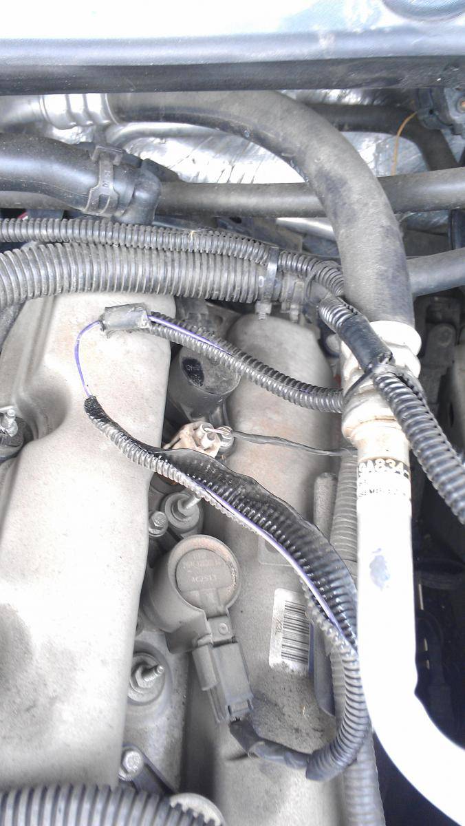

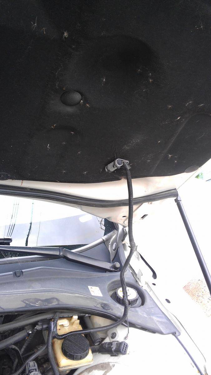

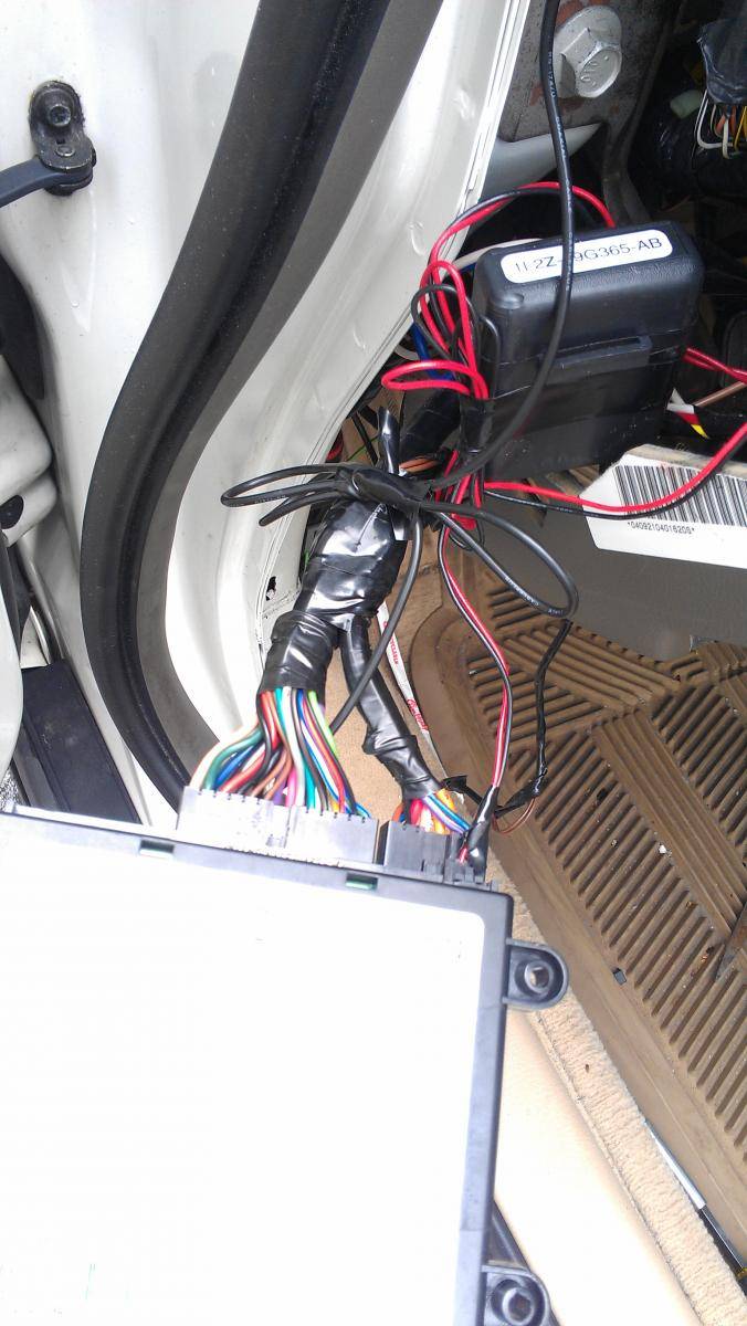

ahaha -__- i get the message :p I bring my car to a guys know what he s doing he said that all the origin computer in my Lincoln have been change he plug a scanner to and he saw that i have misfire from my coil 5 4 i think and he detect a code c..? what is a code C??? and he cut a wire connecting at one of my ignition coil... and my red light stop ticking !!:D so guys tell me the right things thanks a lotttt guys !! next week i make my coil change!!!
Excellent news. Make sure you do ALL the coils and plugs. You don't want to have to chase failing coils for the next year!
