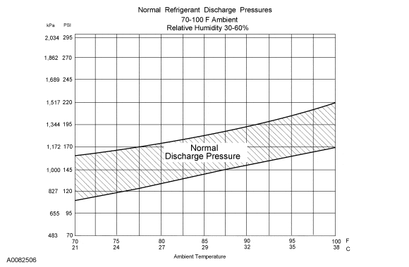

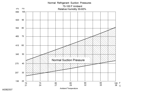

300 if it is close to 100 degrees there, otherwise somewhere in the 200s. 5v doesn't sound right, but I'm not positive on that. Pretty sure it has to be over 110 to turn the fan up.
so what does that mean?
Okay, so more precisely, 120 is normal for 75 degrees. It would have to be over 125 degrees to expect 300 psi. Make sure he/you goes by the LS pressure chart and not a generic one.
I found it, Ill use it tomorrow. Posting it here for others sake.

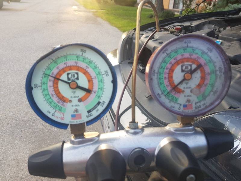

Here are the pressures taken at a ambient temperature of 65°. Low side is insanely high and high side is reasonably low.

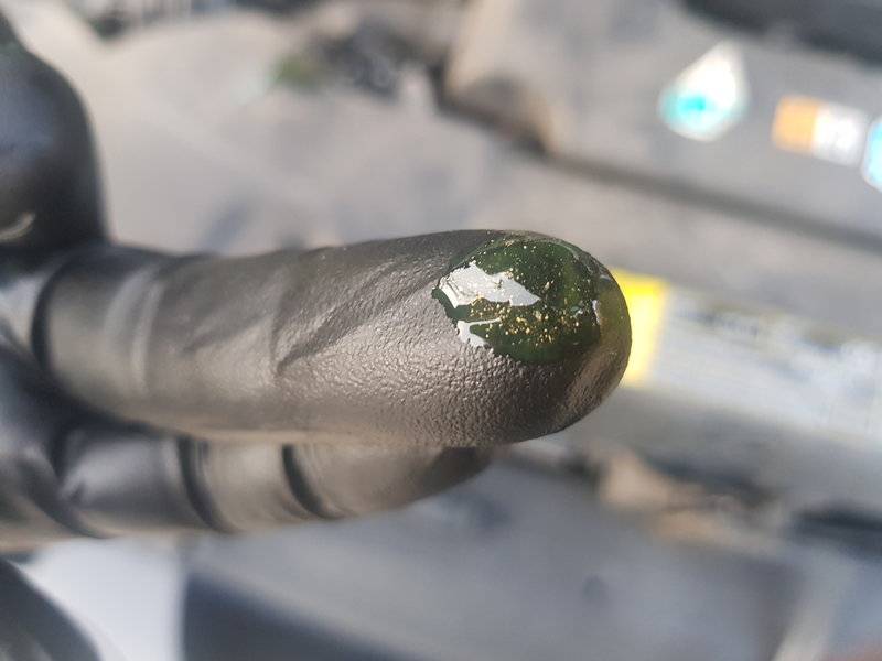

Here is a shot of the liquid that came out. Too note as well that the pressures did change when we turned the AC on compared as to when it was off.
I can't tell if that is the texture of the glove, or metal flakes.
I do believe it's metal flakes. They looked silver in person. What are your thoughts on the pressures?
Pressures no longer matter if there are flakes in the compressor oil. (Though the pressures and the flakes both support drastic compressor failure.)
