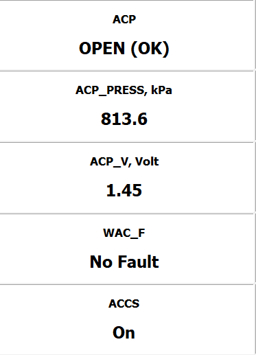

I just went out to check, the Engine fan wasn't spinning when I had the AC on, however I did a KOER test earlier and it spun the fan to max. I also do hear the engine fan rev up when I turn it on after the car is already warmed up. Here are the screen shots from any data that ForSCAN could collect, as well as what they mean (I'm sure you know already but just in case and/or for other readers :) ).
I was told by my neighbor that the sensor should be getting 5 volts and the pressure should be near 300 psi. this equates to roughly 110 psi (kPa to PsI conversion). I thought that this was weird because that means both the pressure and voltage of that sensor are down to about 1/3 of normal operation.
He could be wrong based on he's never worked on an LS before, but it's just an observation until Joe confirms/denies. Of course, we aren't taking the computers word for it and we're testing the pressures with gauges tomorrow.
300 if it is close to 100 degrees there, otherwise somewhere in the 200s. 5v doesn't sound right, but I'm not positive on that. Pretty sure it has to be over 110 to turn the fan up.
