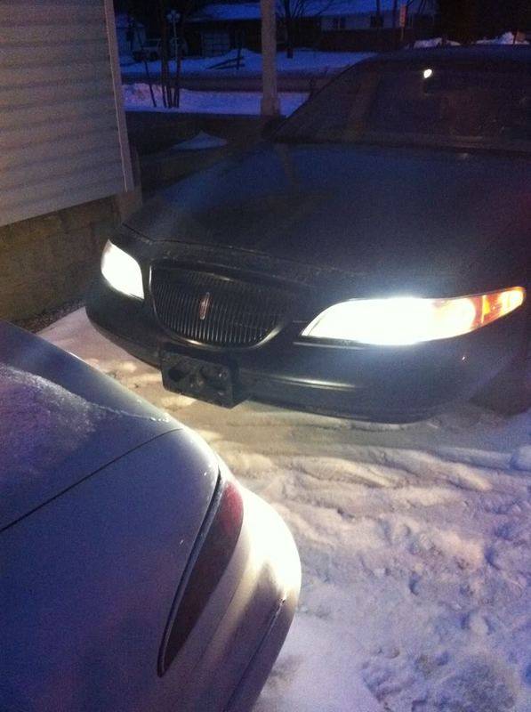

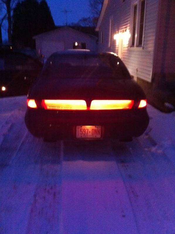

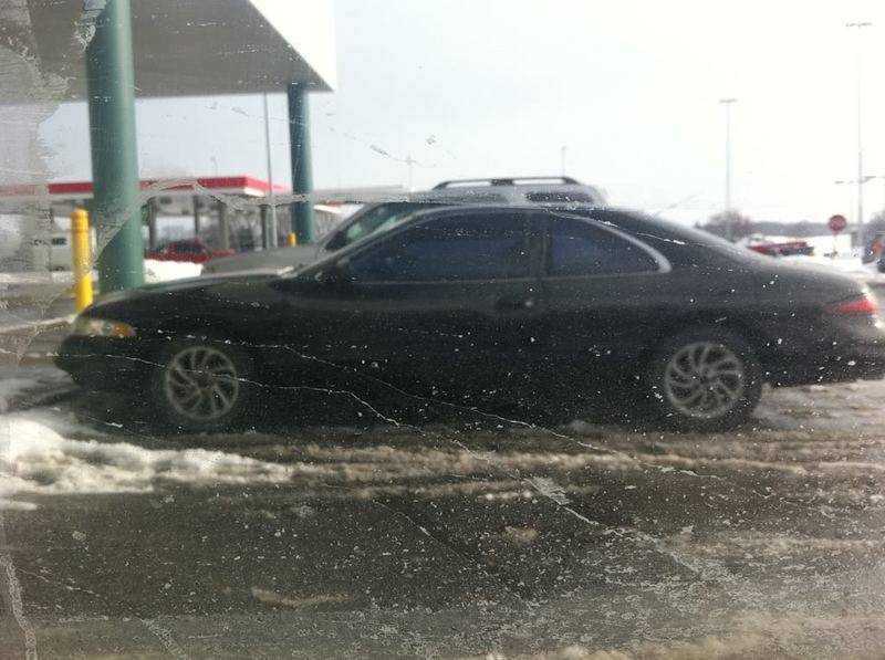

Hurray for photobucket app couple crappy pics one on the highway yesterday afternoon sitting my other car on break and a couple last night I texted my buddy to show the lighting
