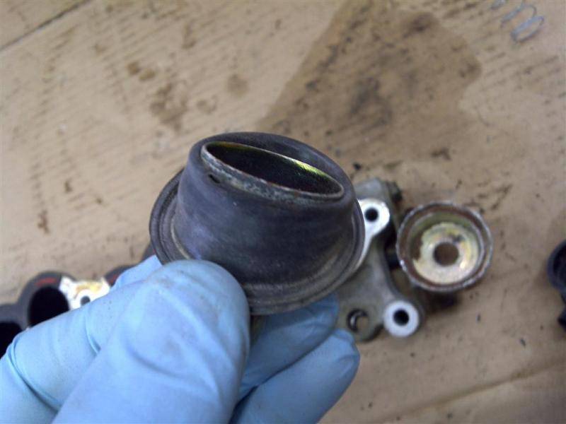

Here is a picture of what is causing the problem. The actuators relys on engine vacuum to close the IMRC's. The rubber boot rots out and causes a vacuum leak that causes the IMRC to not close (stays open). You will need to find one in a junk yard. If you remove the IMRC's you will have no torque for getting the car rolling.
can you pull this rubber boot out of a different imrc. i might still have mine laying around from when i did the swap the boot on the drivers side was still good. maybe that might help him
It depends upon what the problem is. IT could be a boot, but it may also be the sensor. The whole system needs to be checked.
Sorry but the boot is a one way trip. To see it the housing gets pretty beat up. The whole can has to be replaced as a unit.
Nothing a little peice of rubber and super glue cant fix :)
