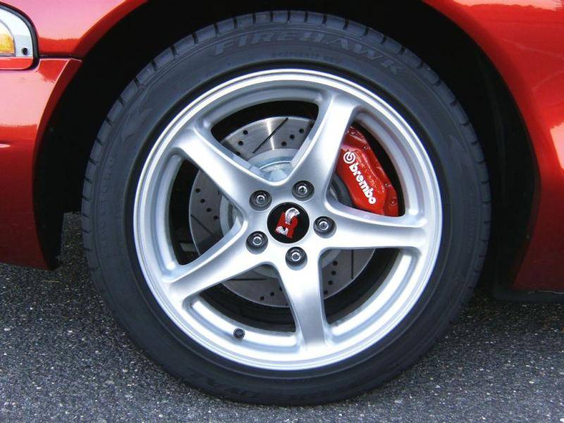

There aren't any pads in the world that will make the stock single piston calipers work like 4-piston Brembos.
However, I will admit I painted my calipers red 'cause it looks good. ;)

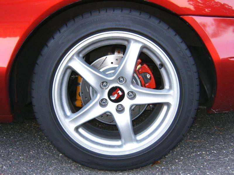

All three of my cars have Brembo calipers and 13" front rotors, and all three stop significantly better than they did with the stock brakes, with less component wear.
