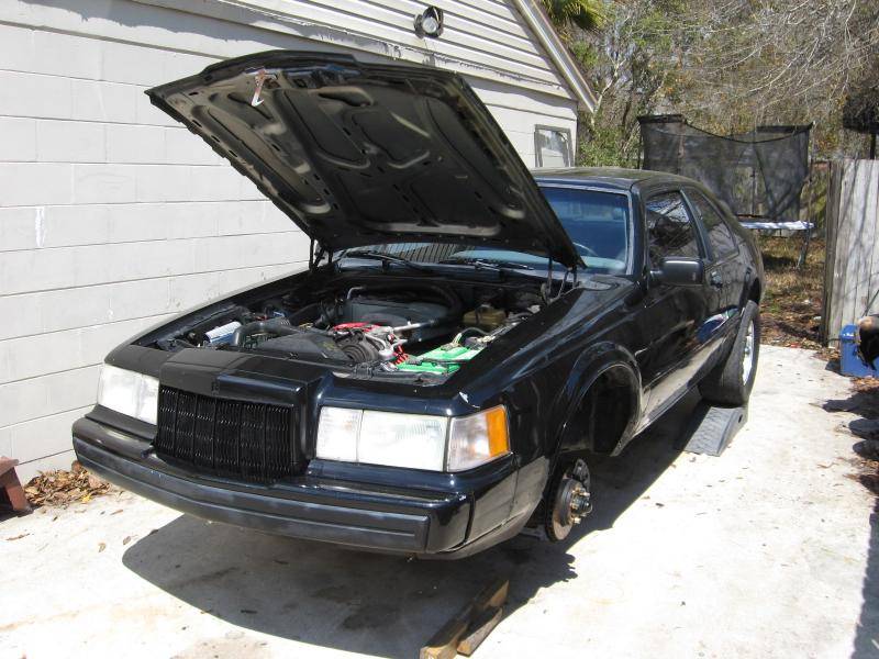

heres a pic as of yesterday.lower molding off.center caps on.

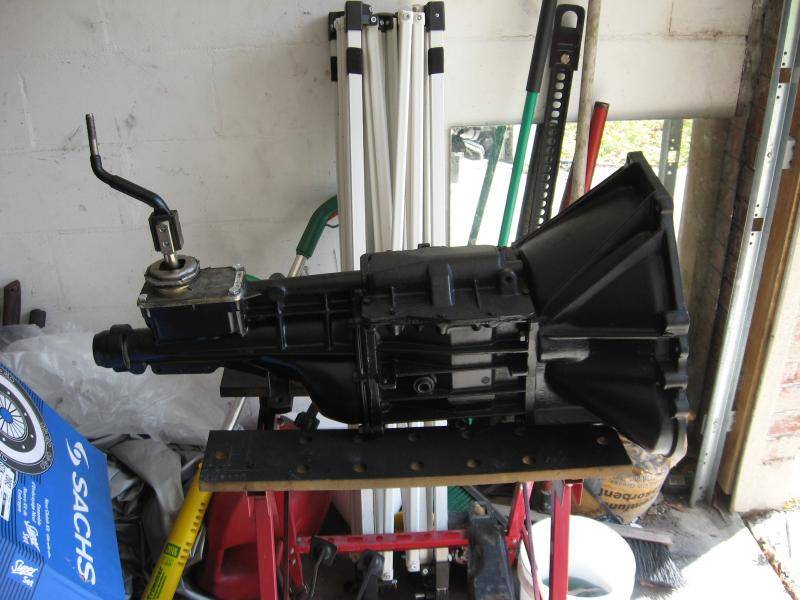

little update,i have not had time to work on the car but i did get a t5 tranny today,now i just need a bellhousing,clutch cable and quad,clutch,pressure plate,flywheel and d shaft made.
With the T5 swap might I suggest you get a double hump mustang X-member and tranny mount too. :shifty: Gives you a lot more room for the exhaust and such.
Car looks WAY better without the lower molding. I am definitely doing that to mine now after seeing yours. Car looks BADASS man, lovin those rims!:cool:
the ribbed moldings, right? someone removed the mid-moldings on mine and it looks a million times better. how do you think yours looks without the ribbed moldings but still the wheel well moldings? or did you remove the ww moldings too?
Mike
i kept the ww...it looked stupid with them off.

a 87 turbocoupe wc t5 with a 3.93 first gear
i just need a backplate,flywheel and clutch parts and cables

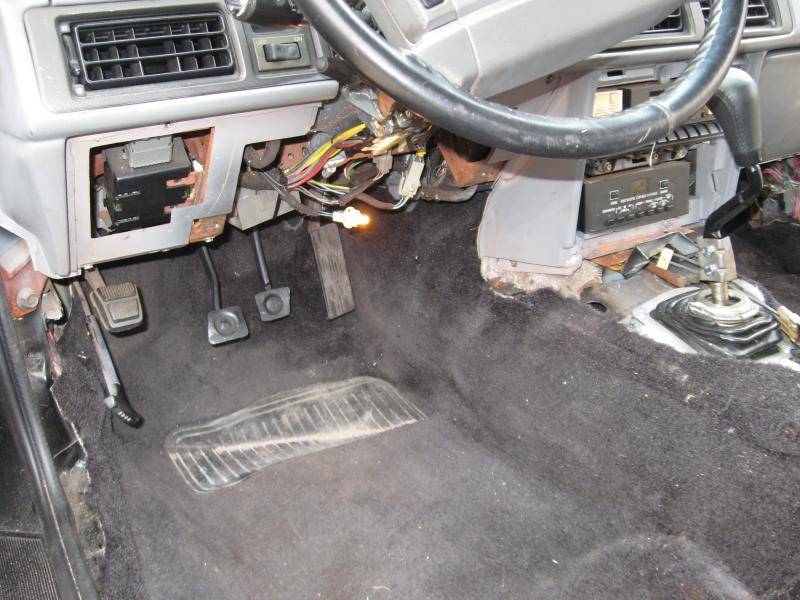

ok,i have looked at 87-89 pedals,90-93 and 94 pedals,the 94's look like 87's after they are cut....would the 94's work?

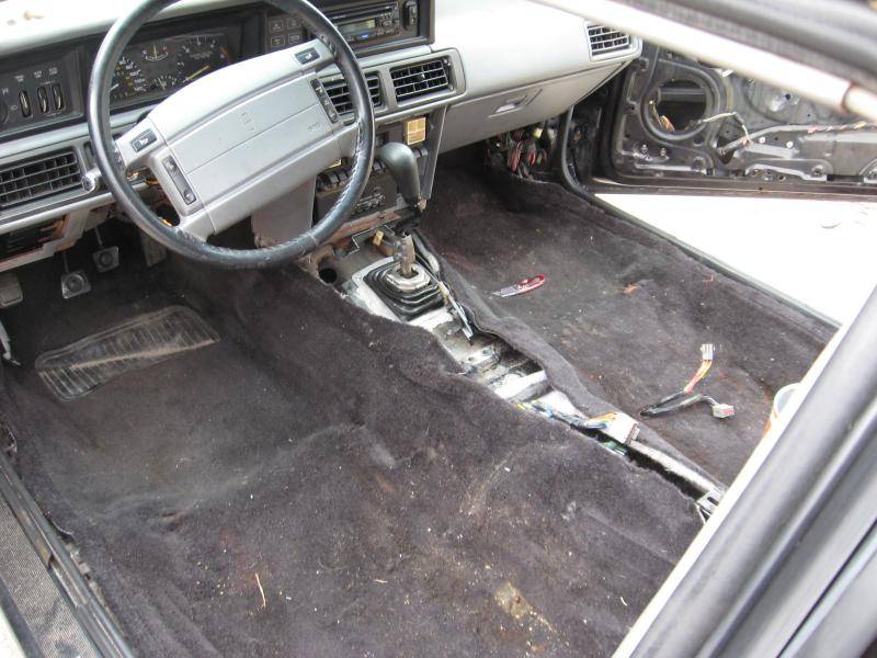

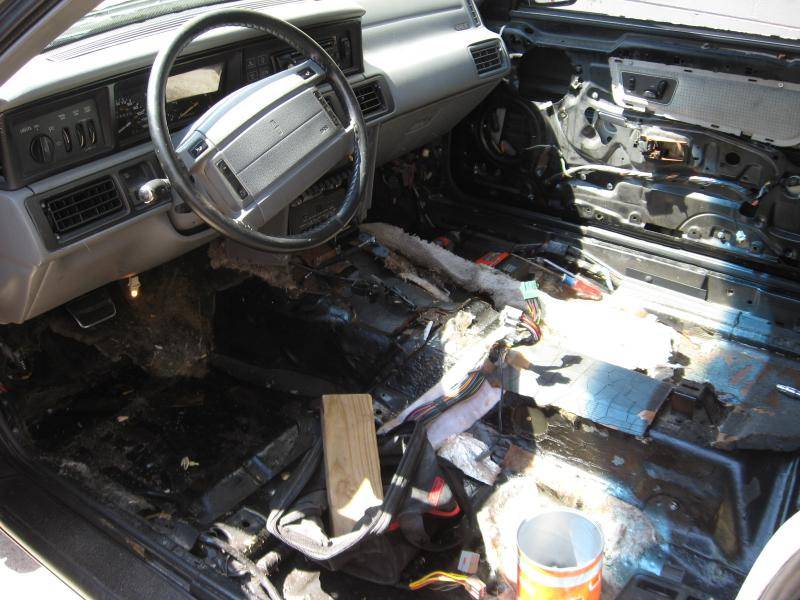

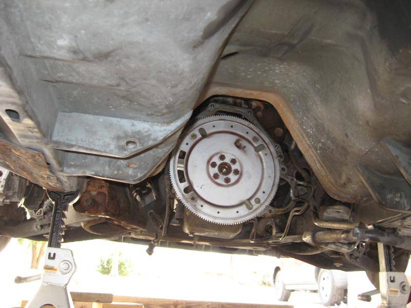

the swap has begun.......all the auto stuff is out.tomorrow the 5 speed stuff gets bolted in.the pedals are cut to fit now.the t5 tranny i have has a 3:97 first gear ratio,this thing is going to have an awesome launch.
ok how do i hook up the neutral safety switch and back up lights?my tranny does not have the safety switch on it,no place for it.i have some switches that where on my clutch pedal assembile.and how do i wire the reverse lights to come on when i put it in reverse?
on the neutral switch i really dont care about it...i just want the car to start.and my car is a 90 lsc se.
it is a running and driving beast....it really woke this thing up.gonna drive it pretty tame for a few days and get used to it and break all the new stuff in.this was an awesome mod and not that hard.
