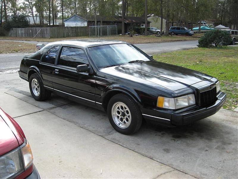

I just bought an M7 to go with my two M8's because thats what I really wanted but couldnt find one at the time. Im a long time fox body lover so I like the squared up lines. My goal will be to find a white bill blass or lsc to drive to work and get the one I just got ready for some friday night bracket racing. So I will eventually be selling the M8's . They are way faster than the 7's but I can change that with a few bolt ons. My question is about the Arnott conversion springs. I saw them on Ebay for 3 something bills. Do those springs actually fit on the air bag control arm without the pocket? Should I get the peices needed from a Mustang or T bird instead? I want it lowered ,so Im going to have to cut them anyway. Does anybody make a cowl hood . If not whats the best looking ad on cowl that someone has grafted on? What is a good sized tire for the rear on stock rims for some meat out back?

eh. unless your air suspension is totally shot i wouldnt ditch it for conventional springs. do a thorough search here, fordvschevy, and lincolnsonline. you'll find all kinds of info on the topic. those who are for it and those who arent. and a few who've done it and regretted it. theres a few members like you who built some hot-rodded marks and have gone as fast as 10.90's on the stock suspension. its better weight transfer with bags.
Im quite a few paychecks away from 10.90's. Things arent as good as they used to be. How much more does an M7 weigh compared to a fox body mustang in the same trim ( drag race set up, no a/c, p/s, one race seat, weld wheels, etc..?) Please dont flame me for ruining a collectors item , because this one was not a gem by far and was not worth restoring to stock. Now the white one that is on my list will be pampered and left stock. Can the double U joint be

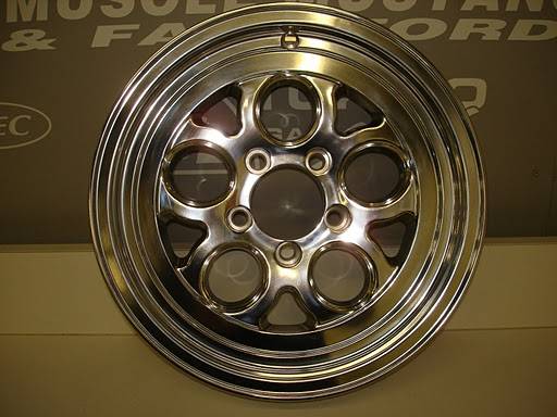

They are the Sumitt Racing Drag Thrust that just came out. I saw them online and I googled them and didnt find any cars that had them on yet, so I decided to be one of the first. I am very happy with them. They copied the look of those expensive weld wheels on the prostock cars that are gold in the middle. The skinnies are much stronger than welds , so you dont have to worry about breaking them on the street. The fronts are 4x15 with 165r 15's. The rears are 8x15/ 5.5 bs with 275/50/15 MT drag radials.

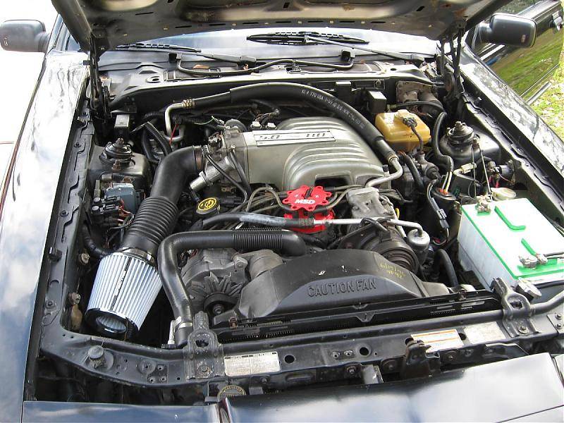

heres some recent pics....notice the msd cap and dis...next is plug wires and plugs. it also has a msd coil,flowmasters,no cats and thats about it for now.
one suggestion. ditch the cone filter and get a fenderwell cai kit. that filter is doing more harm than good by drawing in radiant heat from the radiator and engine bay. dont let the few mods you've done be negated by heat. heat kills power period.

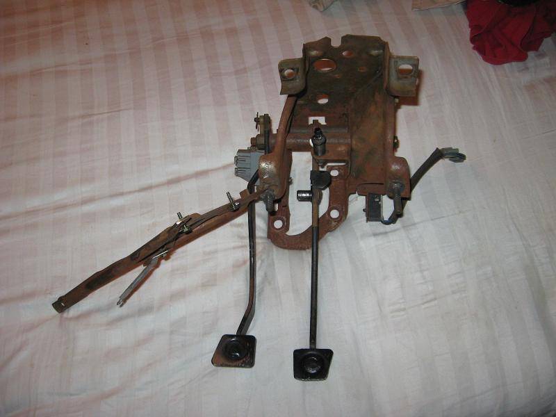

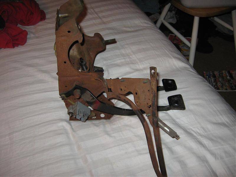

thats just a temp thing...where the filter and battery is twin t4's will be there soon.and a 5 speed is going in very soon,got my pedals today.its also getting a stroker motor in the near future,331 or 347 dont know which yet.anyways heres the pedals.
