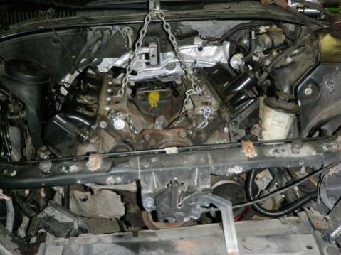

here are a few pictures. more to come very soon! these are the long tube headers that brian fabricated. not quite done but getting close. the engine in the photos is a spare that he is using for a mock up

Mock up engine
The mock up engine is getting pulled out this week to make room for the black's real heartbeatMOCK UP ENGINE.jpg
