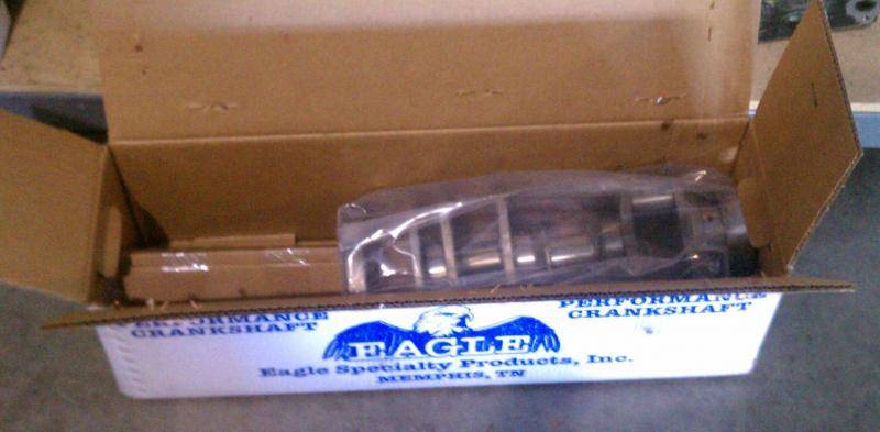

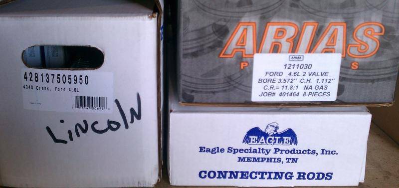

    FINALLY some progress. Took forever just to get these parts but at least it's a start :)
    Eagle 4340 balanced forged crank and Eagle ESP H-beam rods
    ARIAS forged pistons

    11.8:1, I like the sound of that, good luck mang

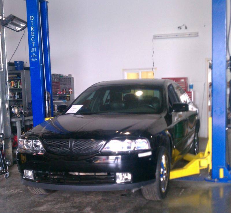

    the stroker kit is going in the 4.6 which in turn is going in my 2000 LS.
    Performance Driven here in indianapolis is doing the build and install.

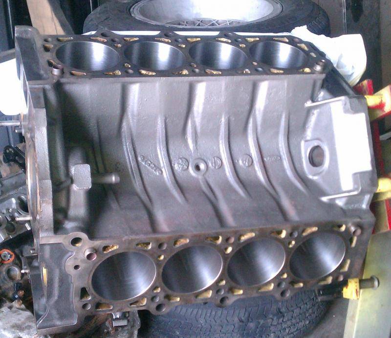

        Dropped off the rear end parts at the shop today.
        I told them once they have a bracket made that a few guys on here might be interested in one so to keep that in mind before they install it.
        Also the machine shop has the block finished.
        They're picking it up tomorrow and dropping off a NPI 4.6 head to be cleaned up. We were planning to use Trickflow heads but after more research it turns out the TFS heads are really only good with forced induction. So there's no reason to spend the money when i'm staying N/A with this build.
        Brian has a flow bench and is experienced with porting so he's going to experiment with the stock heads and go from there.

        block has to go back to machine shop to be honed again. not quite enough clearance in the four center cylinders.
