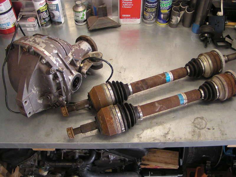

If your talking about what is on the work bench on the left hand side (diff, center section), that IS gold, I will charge you a $250 core charge for that till I get a customers take out unit back.

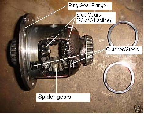

The diff I got is out of an explorer with 31 spline side gears, but I have a set of 28 spine side gears to put in it to make it work in my car.
Dan, that's the carrier, lets not confuse the boy now ;)

I'm pretty sure that only 03/04 cobras and explorers used 31 spline side gears in the carrier. As far as stuff newer than 05, I dont know if any of this applies. Anyway, everything that uses an 8.8 has 28 splines at the wheel end. If you want a plug and play diff that will cost you the least, you need something out of a mustang GT, and I think some v6 cars had an 8.8 limited slip? They will have 28 spline side gears. The side gear is what you are sliding the axle shaft into at the differential. An 03/04 Cobra diff and explorers have 31 spined side gears, and are not "plug and play" with your current stock Halfshafts(axles) If you got either a carrier from an explorer or 03/04 cobra you will either need cobra axles, or I believe you can change the yoke on your shafts with 31 spline yokes, or do what I am doing and get an explorer differential, and install 28 spline side gears. Trying to be as lamen as possible but I dont know if it worked.
