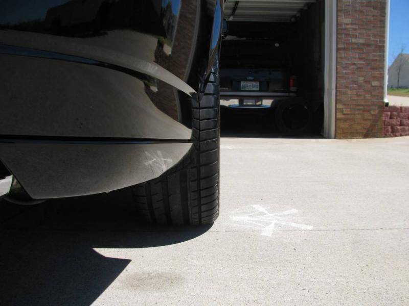

I'm just going to wait for a postback on this one. I want to see some pics of the tire squeezed on the rim and how it sits on the car. If it doesn't look good, I'll just go with 245/45r17's like I originally planned. I'm just so over and done with these Michelin's that it's getting hard to wait. :)
Finally got them installed last night, they went on the factory rims with no problem.

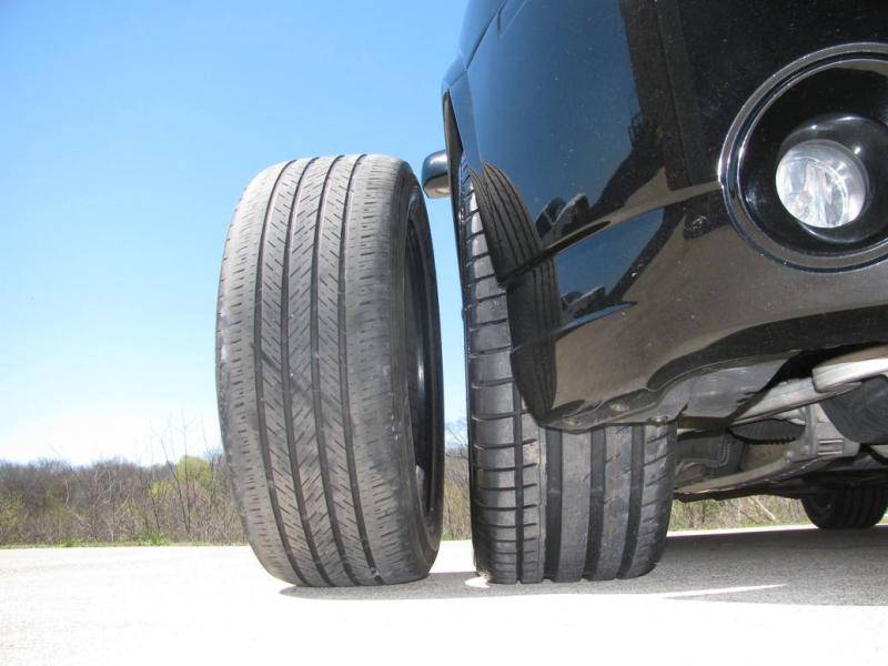

The 255's Continental's measure 9.75" acr0ss the tread, where the factory Michelins measure 8.25".
Quite a bit fatter. Looks are much more beefy, old school muscle car like. Ride is smoother and quieter. Steering is a little sharper and at least on mild bends on the interstate here, once the wheel is turned it holds a line with much less correction needed. I need to break them in then turn them loose.
I just washed it but have not Armor -All'd the tires yet. Will take a picture here in a bit...

Been wondering what happened to this! Now I know. Looks like there is either a very small amount of curl at the inner edge of the tire. Doesn't look stressed that much which is good. And yeah, 255mm = ~10.04", so 9.75" is in the neighborhood, and it's all somewhat subjective to how the manufacturer measures it.
Might just skip the whole Jaguar XF "Cygnus" rims and just get the same tires. Also real interested to know how it feels with some spirited driving and/or in the rain. :)

The pictures were taken before I adjusted the pressure down a few pounds, so they actually set a hair flatter.
The 255's on the car actually measure wider than the 255's I have on my Explorer. I realize every manufacturer varies a bit, but the difference was substantially more than 20mm which should have been 3/4" or so.
