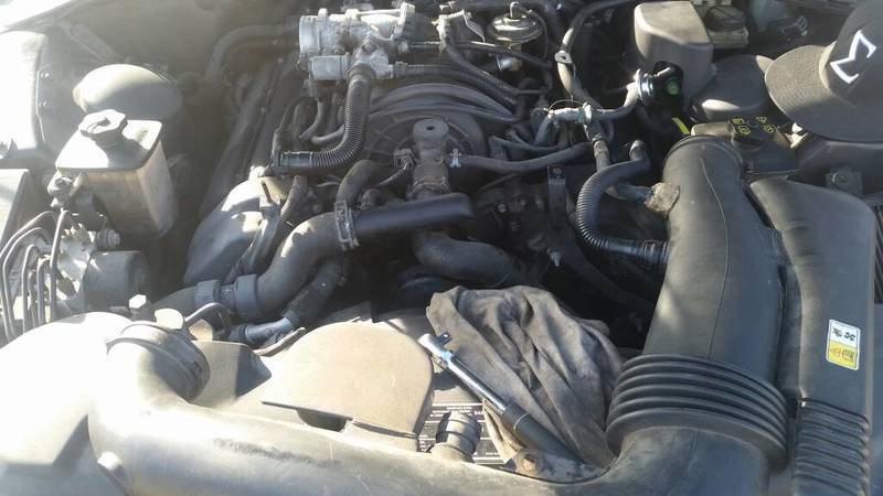

He's steering you wrong. He's talking about the fuel line quick disconnect tool, but the connections at the fuel pump don't use those. The tool he's talking about is needed at the fuel rail and the fuel filter.

Aw crap. I missed the picture of the fuel pump. I saw Kid's post quoting Loud's fuel rail treasure map and thought Kid was still talking about being at the fuel rails I guess. Maybe the word "disconnect" threw me off.

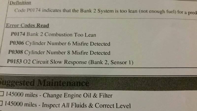

Like the others have already stated, you really need to include an OBDII reader in your arsenal of tools there Mr. Mechanic
There are most likely some important DTC's stored that would point you in the right direction but yeah first things first ~ fuel, air, spark.

These are my codes...

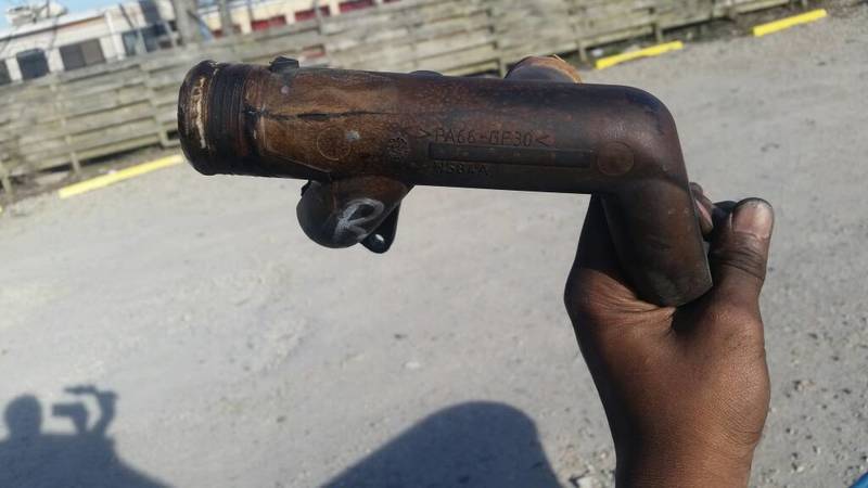

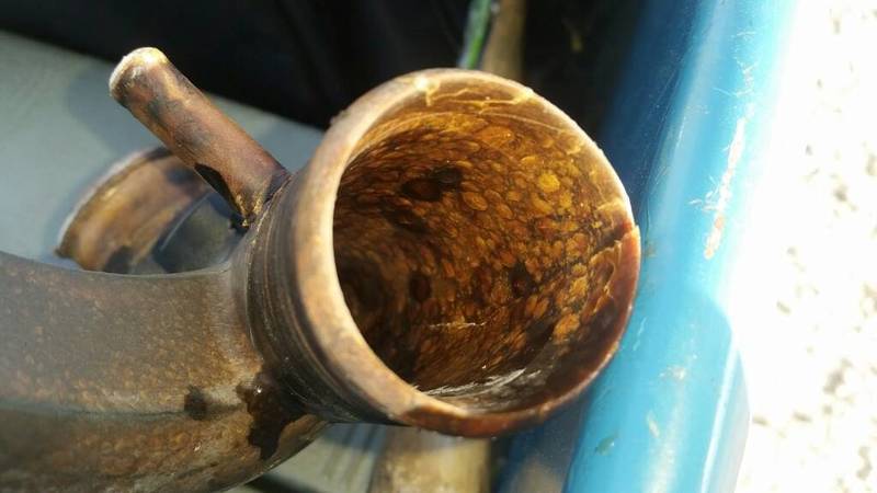

After further investigation, the pipe in the front of the engine has a crack in it.
I'm lucky I don't look like Harvey Dent. It exploded in my face after driving once I opened the hood yesterday. Thank you Jesus.
I swapped out my Coolant Outlet Tube with a junkyard one. Had a hairline crack.

My coolant boils to the point where I can feel it rumble when the car is off. After driving for a while it explodes under the hood. I just replaced the Outlet Tube. Could the Degas bottle be bad?
