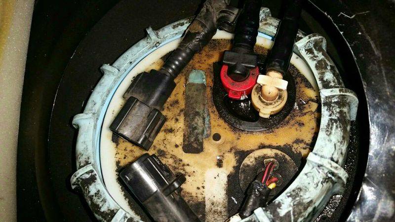

I can't get these suckers off!!!

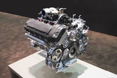

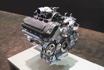

thats really it, just like every single V8 I've ever owned, the fuel injectors are at the base of the intake manifold, just above each valve cover, evenly spaced out above each cylinder, the fuel rail connects to each injector.
you can clearly see them in this picture, it is the only horizontal silver/metal tube in the picture. (I though some LS's were painted black?)
if you still cant find the fuel rail, then make sure that you have a V* because the V6 has both rails running next to each other right down the center under the upper intake...

He's steering you wrong. He's talking about the fuel line quick disconnect tool, but the connections at the fuel pump don't use those. The tool he's talking about is needed at the fuel rail and the fuel filter.
