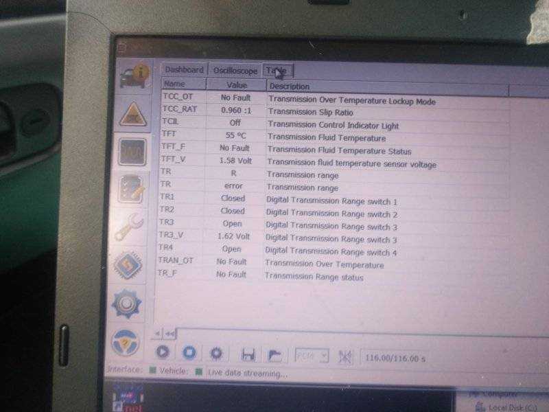

      I am dropping the car off in the am to have the transmission checked out but here is what I can see with ForScan in the meantime

      Yeah ....that is all Greek to me ...hence you must find out if this problem is electrical or mechanical ...it is of most importance to figure out the difference and connection relating to the transmission problem...it's in your best interest to bring your car to a shop that has the right computer in order to retrieve the correct live data while car is driving and the transmission is functioning or in your case producing dysfunction
