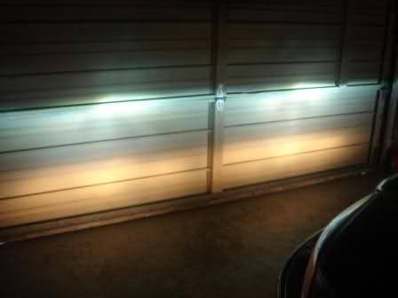

Well here are the pictures everyone has been waiting for. I am very busy with school but I just snapped these photo's for you all. These front shots make it appear to have glare, but the projectors do not give any glare on low beam. The setup looks a whole lot better in person than in these pictures! Bosch projectors simply rock!
Low Beam only
Low Beam with fog lights (soon to be upgraded:) )
High Beam (the projectors have a solenoid that is activated with the high beams as well)
Low Beam in parking garage during the day (nice, bright, AND even cut-off)
Low Beam with Fog lights(fogs are silverstars..big let down)
High Beam in parking garage during the day (notice the projectors have no cut-off line when the high beam is activated. This puts more light further down the road, and a lot more at that!)
About 50ft away from the wall in parking garage
Here is a shot of the back of a projector. These are sealed a lot better than it looks. I have driven with these for over 6 months without any moisture problems.)
This is the Ls just sitting in the parking lot waiting to be driven!:D
