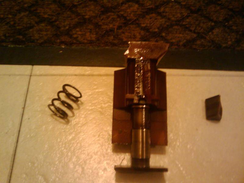

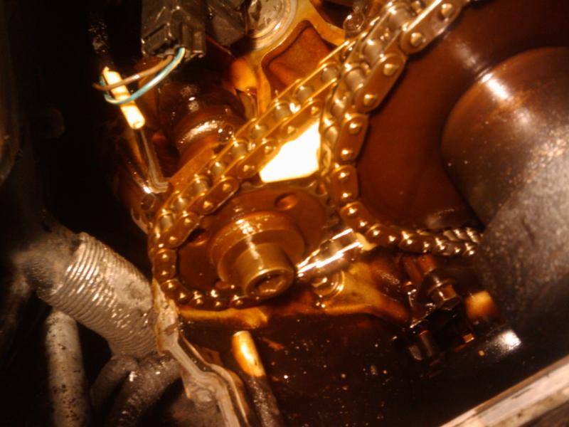

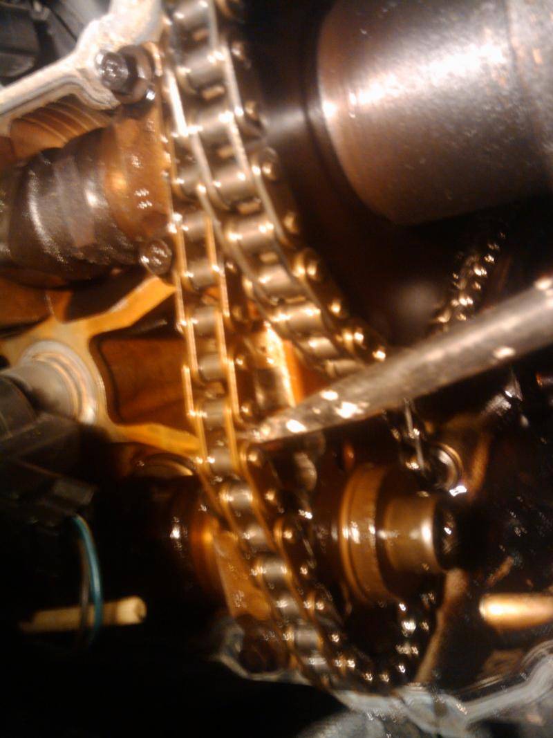

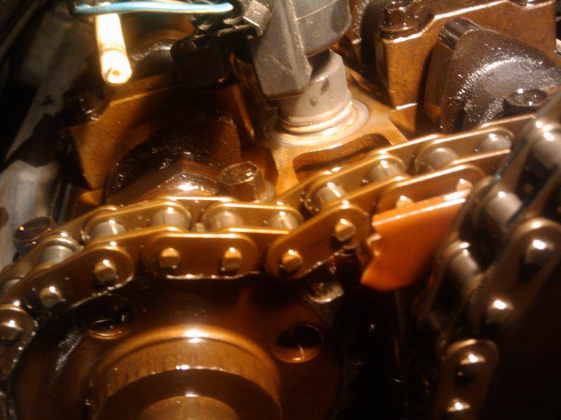

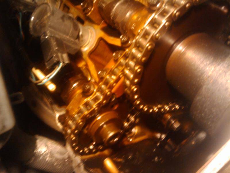

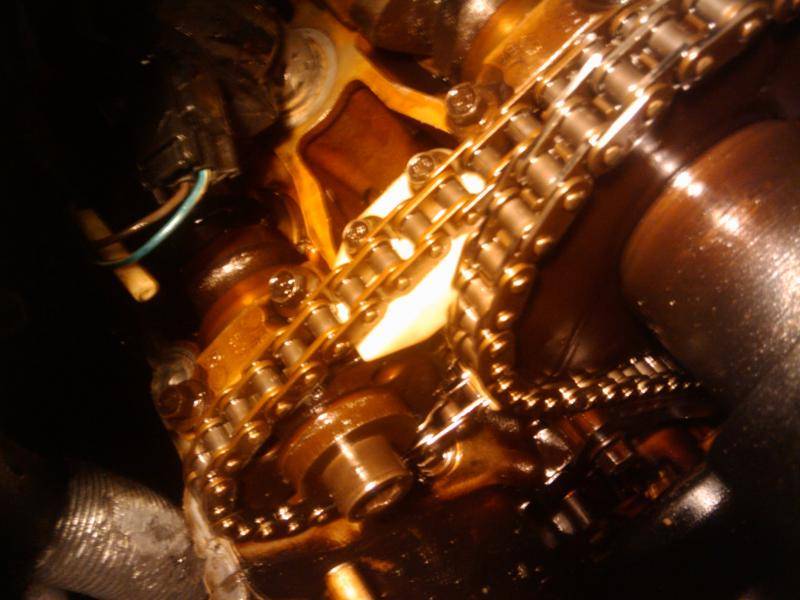

Just had my car repaired and it was the secondary timing tension. Here's a few pics and videos for people who may face the same problem.

New Tension
