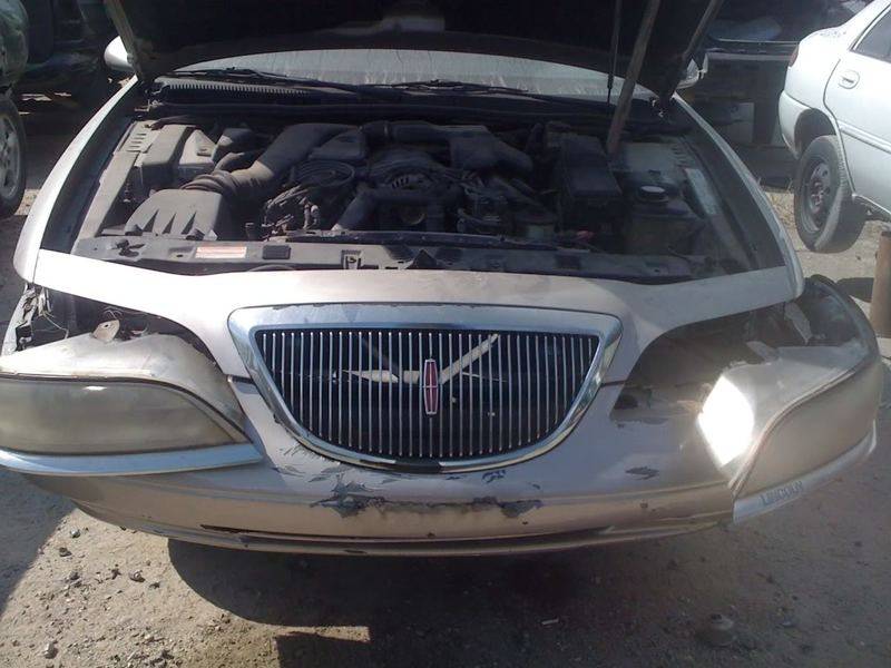

I just picked up this 97 for a parts car, has a blown head gasket
