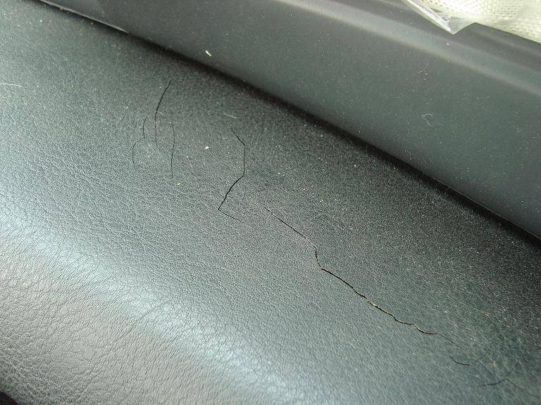

How difficult is it to take out and swap out the entire dash and airbags?
After the bags deployed on my car the passenger side cracked my perfect black dash... so now I need to find another one and replace it when I get it back in action.
Also, I've never had to replace airbags before either... any Idea how those come out?

Yes, It cracked the actual dash pad itself when the "door" to the airbag blew open..
