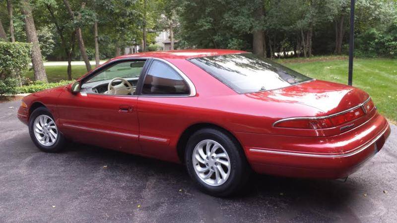

I just picked up a real nice 1996 Mark8 with only 31000 miles on it. I had it checked out, new tires, detailed, etc, and she ran like a beauty! Pulled it in the garage and she sputtered a little and died. Now, it turns over but it won't run a bit! The local garage has it and they think it's the Variable Load Control Module.
Does anyone know where I can buy one? I'm brand new to this forum and will appreciate any and all help.
Thank you in advance,
Ed

VCRM gone bad in only 31000 miles? Thats some ****ty luck. Beautiful car BTW

Seems like it! That's why I want to buy a spare!
The car is for my son. It seemed like a decent car for the money. And of course, I always loved the looks of them.

You're a good Dad. The boy will learn the finer points of maintenance or the car will not perform up to spec's. Trouble shooting, too. The car looks spotless. Welcome to you both. You will not find a more generous forum.
