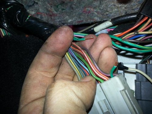

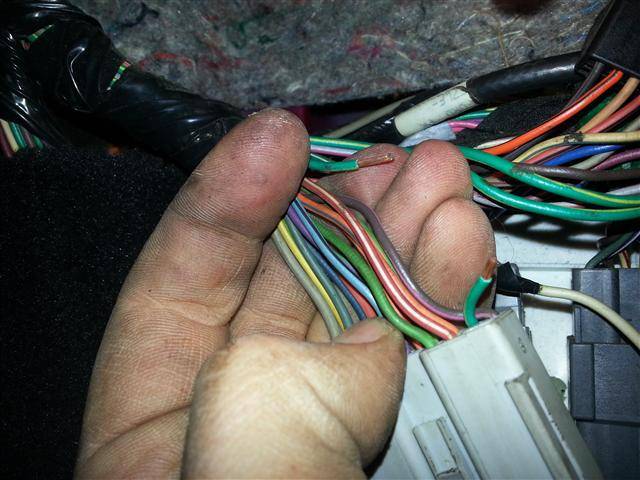

You car is telling you something......it longs to have the air ride back.
Shows on the message center "air ride switch off".
Cut this wire under the glove box, behind the kick panel....or install air ride.
OR, you can pull the pin out of the connector, so that if you ever need to reinstall the system, you didn't cut anything. I hate when people just cut wires.
