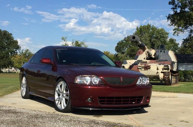

    LSE Gen 2 bumper on my 2000 LS.

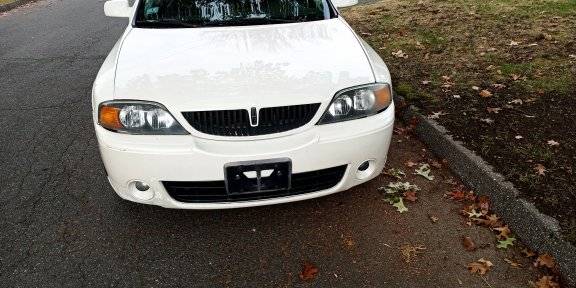

    06 lse bumper on a 2001 I have gaps on corners of head lights the plastic tabs onder headlights don't line up

    I still have a gap under headlight no matter what I do

    My son said you need to swap bumper, bumper cover and headlights. I've looked at this and the line between the headlights and the bumper does appear to be lower on gen 2 cars than gen 1 cars.

    Not the metal bumper, the plastic/fiberglass part above it. What the headlights bolt into, what the top of the bumper cover slides into. That doesn't fix the gap though, that allows you to install the bulkier gen 2 headlights. The white pic above seems to show the real issue is the gen 1 headlights don't stick far enough forward to cover the gap
